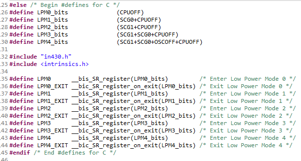

  • sHi Swarna,
    Yes.
    Also, In case you weren't aware, there are pre-defined "intrinsics" that you can use.  They are located in your device's ".h" header file.

  • Hi Swarna,
    No.  The section of code you are showing only configures the system clocks.  You do that first in your code, then later you put the CPU into one of the LPM modes using the intrinsics.
    Here is example code from the selection of MSP430F5419A examples in the TI Resource Explorer.
