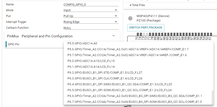

Hi Everybody ,
I need interrupt cababilities on P10.1, P10.2, P10.3   .
I m in TQFP package .
now in Pinmux  I can see  interrupt is available , while  in the datasheet  they are reported as "simple"  GPIOs
please coudl you confirm me   these pins are interrupt capable ?
TRM is not so clear it seems any P10x is interrupt capable : could you redirect me to proper paper ?
thank you
best regards
Carlo

  • HI Srinivas ,
    if you use the PINMUX  utility  you can set  Interrupt on P10x ...
    so  device can only do  interrupt on P1 to P6 ports ?
    thank you
    regards
    Carlo

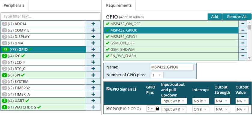

  • Hi Carlo,
    The https://www.ti.com/tool/PINMUXTOOL page suggests using SYSCONFIG https://www.ti.com/tool/download/SYSCONFIG. For the MSP432P4111 device, if I enable the interrupt requirement, it does NOT show P10. It only shows P1 - P6. See image below:
    If I specify the interrupt as NONE, then it shows P10. See below.
    Hope that helps.
    Srinivas
  • Hi Srinivas
    please start for a new project  , I m on Cloud version  , you will be able to enable interrupt on port 10  and genereta proper  code  ( in attach )
    GPIOMSP432_P10_1 | GPIO_CFG_IN_NOPULL | GPIO_CFG_IN_INT_FALLING,
        GPIOMSP432_P10_2 | GPIO_CFG_IN_NOPULL | GPIO_CFG_IN_INT_RISING,
        GPIOMSP432_P10_3 | GPIO_CFG_IN_NOPULL | GPIO_CFG_IN_INT_HIGH,
    are you sure  no interrupt capabilities on the device  ?   it is a PINUMUX issue ?   please I need a confirmation here
    thakn you
    best regards
    Carlo

  • Hi Carlo,
    The datasheet section 4.4, Table 4-3. Signal Descriptions clearly states that the interrupts are only available on ports P1 - P6. We will have to go with that.
    The downloadable https://www.ti.com/tool/SYSCONFIG which is a release in September 2020 also clearly shows only P1-P6 if interrupt is required, as I mentioned in.my earlier post https://e2e.ti.com/support/microcontrollers/msp430/f/166/p/945095/3492031#3492031.
    The problem could be with the PINMUX tool on the cloud which was a January 2020 release. There must be a bug in it.
    Srinivas
