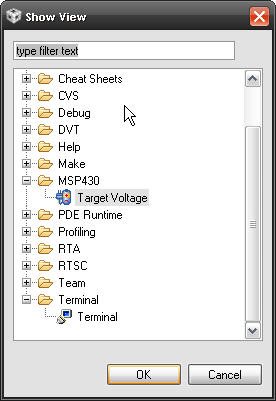

  • Hi Joydeep,
    the CCS (as well as the IAR sources) for the Sensor Monitor demo are here http://www.ti.com/lit/zip/slaa378 , the app report is here http://www.ti.com/lit/pdf/slaa378.
    CCS also has a build in terminal window (IAR too); click on VIEW-->OTHER for opening it.
    Terminal looks like:
    The interface configuration is done by using the buttons in the Terminal window.

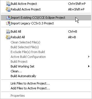

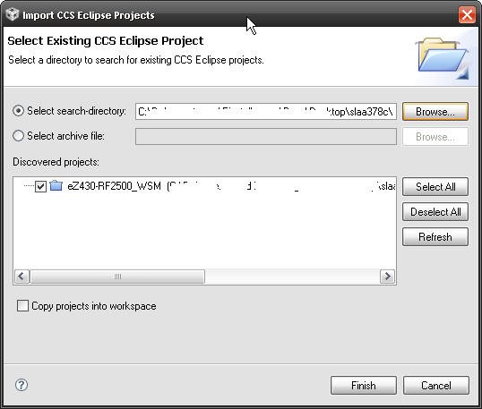

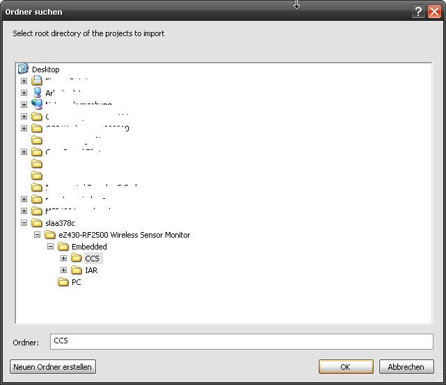

  • Hi Joydeep,
    1.) the device on your eZ430-RF2500 (or eZ430-RF2500T) is a MSP430F2274
    2.) download and unzip the Sensor monitor demo (slaa378c.zip; find it here http://focus.ti.com/docs/toolsw/folders/print/ez430-rf2500.html)
    3) open CCS and click on PROJECT-->IMPORT EXISTING..
    4.) Click on BROWSE and select the root directory of the project to import (see below)
    5.) select CCS and click OK. Your window should look like below now:
    6.) check 'copy project into workspace (un-checked in my screenshot) and click on FINISH
    7.) now, your project is ready for working with
    8.) click on PROJECT->PROPERTIES->BUILD to select the configuration (AP or ED)
    10.) do not alter the device variant and/or linker command file!

  • Hi Joydeep,
    be shure to CHECK COPY PROJECTS INTO WORKSPACE before you click on the FINISH button! By doing so, every piece of soure/include or whatever code will be copied into your workspace folder. If you leave it unchecked you will need to keep the un-zipped slaa378x-folder in it's current location!
    As already pointed out above, the selection of the Access Point or End Device code to be build is made under PROJECT PROPERTIES by selection the build configuration from the drop-down menue (as shown above).

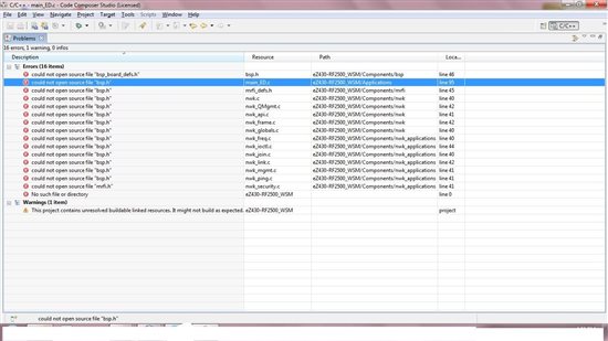

  • Hi
    Thanks so much for your information! I seemed to be using 4.0.2.01003 version and hence there was some problem concerning the
    workspace. Now I have modified it to 4.1.3.00038. Things have changed.. the workspace is being built fine but the code seems buggy..
    Is it only due to path '#include xxxx.h '    problem or something else? I followed asyou mentioned.. afterwards, I tried to build the workspace..
    My next step would be to 'debug' and then 'run'. I attach the printscreen..

  • Hi Joy,
    be shure to TICK the COPY PROJECTS INTO WORKSPACE box!
    I would recommend to delete the project from the workspace and restart as described above. Looks like the included were not copied from the unzipped folder (and maybe you've deleted them after clicking on finish).
