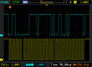

I am trying to troubleshoot by probing the interface signals with an oscilloscope, but I am unable to confirm my read or write.

  • I have made the changes you suggested, but I am still having issues.
    I have figured out that my program gets stuck @
    while(MAP_I2C_masterIsStartSent(EUSCI_B1_BASE));
    I am trying to use the Protocol Analyzer on my Digilent Analog Discovery Board 2, and I'm receiving

  • > Start, h00 [ h00 | WR ],
    This trace looks a bit odd. It appears to be saying that it saw a slave address of 0x00, which isn't what I would expect from this code. Was there more?
    0x00 is the General Call address, which the device [Ref data sheet Sec 7.6] interprets as a Reset request.
    More generally, the SendMultiByte group doesn't check for NACK; though in that case I would expect it to hang in SendMultiByteNext.

  • There is more now
    Error
    Start, h00 [ h00 | WR ], h00,
    This happened after I just fixed my ISR handler name, it was still trying to service EUSCI_B0.
    Now interrupts are serviced and my activity LED turns on. But, I still get errors. I have double checked my slave devices datasheet but I'm going to triple check.

  • What is still 0x00? The trace? or the RXBUF result?
    I would expect the trace to say "h48" or maybe "h90", which makes me wonder if something is mis-wired.
  • The data I'm receiving on the I2C serial data line stil reads as 0x00.
    I've quadruple checked my wiring and have fixed any errors I found. I also probed at each node to verify the VDD, VSS pins etc had the values I expected.
  • I made the changes I suggested, and fixed the ISR name, and I was able to write/read register 0x1F of an LIS3DH accelerometer attached to a Launchpad.

  • I still get the same "Error
    Start, h00 [ h00 | WR ], h00, h00, h00, h00, h00, h00, h00, h00, h00," when measuring using my protocol analyzer and my error condition is still asserted.

    If it helps any, here is a scope trace writing (0xFF), then reading back register 0x1F from an LIS3DH. The top line is SDA and the bottom SCL.
