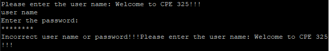

I have a program that requests a user name and password through a terminal (I'm using PuTTY), and then compares it to a pre-stored value.  It is printing the "correct answer" statement prematurely, and I am unsure if it is storing the user name and password inputs correctly, as well.

  • Paul Mitchell said:
    char firstquestion[28] = "Please enter the user name: ";
    That string has 28 characters, and so the firstquestion[28] array doesn't include space to store the terminating null character.
    As a result, strlen(firstquestion) will run off the end of the firstquestion[28] array until it finds the next null in memory.
    I.e. the following will display "Please enter the user name: " and then following characters in memory until finds a null character:
        for(i=0; i<strlen(firstquestion);i++)   //loops through first question elements and outputs
            while(!(UCA0IFG&UCTXIFG));          //waits for character
            UCA0TXBUF=firstquestion[i];         //sets character to for element of first question
    To avoid having to maintain the array size for strings which are constant, suggest instead of an array declare a pointer to a const string. E.g.:
    const char firstquestion *const = "Please enter the user name: ";
