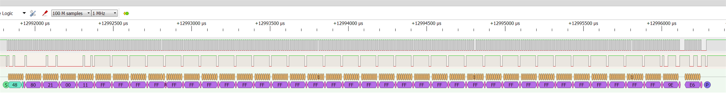

Hello, I have been trying to communicate with the BSL Bootloader in MSP430FR50431 with a very limited success.
I have written a very simple program that enters the BSL and does nothing else before.
#include <msp430.h>
 * main.c
int main(void)
	//WDTCTL = WDTPW | WDTHOLD;	// stop watchdog timer
	__disable_interrupt(); // disable interrupts
	((void (*)())0x1000)(); // jump to BSL
	return 0;
I am able to send the "Check BSL Version" command to the device and the response I get indicates that I have yet to provide the correct password - I get the 0x00 ACK byte, 0x80 header, 0x02 length,
0x3B 0x04 cmd and message and a checksum.
According to the "MSP430 FRAM Devices Bootloader" document (as seen on www.ti.com/.../slau550z.pdf , this means that i need to send the password first.
After I send the (blank) password (that is, FF FF FF FF ....as described in the document on page 18) , the response when I query the version remains unchanged. This is to be expected, since the password was incorrect - the fram should now get erased automatically, as described in the document above.
Once I send the the blank password once again, I would expect the device to be unlocked and thus to obtain the current version of the BSL next time I ask.
Instead, the device freezes, pulling SCL low indefinitely after I send the address byte (ADDR+R).
If I supply a non-blank password instead, I can ask for the current BSL version again and the response is the same as before.
In summary, these are the responses of the device to my commands:
>>BSL Version?
<<Not unlocked!
>>Empty password!
>>BSL Version?
<<Not unlocked!
>>Empty password!
>>BSL Version?
<<(DIES)
Or alternatively
>>BSL Version?
<<Not unlocked!
>>Empty password!
>>BSL Version?
<<Not unlocked!
>>Wrong password!
>>BSL Version?
<<Not unlocked!
This leads me to believe that the problem happens once I have tried to unlock the device. I have tried using the MSP BSL Scripter tool with MSP430 Fet, but it turns out that it doesn't support I2C for some reason. The Uniflash tool doesn't seem to support this processor with I2C bootloader, either.
I have double checked the correctness of my communication using a logic analyzer and the packets I am sending are identical to those described in the document I was reffering to earlier. The only difference is that in the document, the LSB of the length on page 18 is 0x33, but I believe that to be a mistake, as the correct value is 33(decimal), which is 0x21 hex; the Uart example above uses the value 0x21. With 0x33, the checksum is incorrect, anyway.
I have googled the problem and found this:
https://e2e.ti.com/support/microcontrollers/msp430/f/166/t/519983?BSL-Unlock-Problem-FR59691
So I have disabled the MPU in the project settings, but it didn't help.
Thank you for your support. - David!

    I have a few questions in regards to your application to ensure that all of the steps are being followed correctly:
    BSL Related
    - What is the time delay between BSL commands? The minimum time delay before sending new characters should be at least 1.2ms.
    - Could you provide a scope plot of the SDA/SCK signals or a logic analyzer to confirm that the timings are being met?
    - Can you ensure that MCLK is less than 8 MHz before entering BSL?
    - What is doing the BSL programming exactly if you are not using the BSL scripter or Uniflash?
    - Are the supply voltages the same for the BSL host and MSP430 BSL device?
    I2C Related
    What value resistors are you using for your I2C lines?
  • Hello!
    I have experimented with various delays ranging from 10ms to 100ms.
    I can provide you the scope stuff tomorrow!
    I do believe that I have entered the BSL with MCLK equal to 1 Mhz - I have blinked an LED as a test before entering BSL and 8,000,000 cycles lasted 8 seconds.
    I am using a board based around the ESP32 chip from Espressiff.
    I am using a software I2C library.
    I have an application that uses the same I2C interface of the MSP chip to communicate with the ESP32 and it works fine, using the same I2C settings and the same hardware.
    The supply voltages are 3.3V in both cases.
    The BSL responds to the communication, sending I2C ack bits and everything is going well until I actually attempt to unlock the bootloader. Then the MSP hangs, pulling sda LOW.
    The resistors used are 10K, as opposed to the recommended 4.7K for I2C, but we had no trouble with those in the past.
    The I2C clock is 100kHz.
    First I ask for the current BSL version, BSL replies that it has not yet been unlocked.
     Then I tell it to erase memory, not asking for any reply.
    Then I ask about the version again.
    Then I send it the blank password.
    The next time I try to ask about the current version, it fails.
  • On the last trace, that is the ESP32 sending the header? And then it stipes because the MSP has pulled the line low, and it lost arbitration?
    There was something I found a while back with the MSP430F2619 that using the I2C in Master mode, the STOP and IFG flags did not get cleared properly whenever it had a NACK response. I had to add a line that cleared all of the flags in order for it to recover. I do not know if this is a similar situation. Can you tell based on current draw if the MSP is still running, or is it going to sleep? Would it be possible to supply a current trace?
    I assume you do not have control over the I2C flags in the MSP due to the BSL being run. If you can, try running the debugger and checking the I2C registers. See if these flags are getting stuck.
  • Hi David,
    Your screenshots of your I2C timings when invoking the BSL seem adequate in your application as well as your hardware.
    We are engaging with another customer who may be experiencing a similar issue with the MSP430FR59941, and I have looped another member of my team for help. I am in the process of obtaining an MSP-FET to determine a potential root cause in the BSL interface since there do not seem to be any issues from the MSP430 perspective.
    I will keep you in the loop next week as my teammate and I take a deeper dive into the BSL interface and have more suggestions/potential solutions about why the MSP is getting hung up during invokation.

    Even with the newest firmware, the MSP-BSL (Rocket) completely fails. It sends Start/AW:48/W and receives ACK, but then hangs, not sending additional clock signals.
    When I disconnect the MSP, it receives NACK and hangs the same way.
  • Edit 2:
    I have managed to successfully flash the MSP using the MSP-BSL Rocket. (But not with my hardware, yet).
    So far, it appears that the problem is in the master-side i2c implementation and might potentially be related to clock stretching.

  • Okay, I have sniffed the MSP-BSL to BSL communication and used that as a base to make changes to my communication procedure.
    It appears that when sending a password, you always need to try to read the reply.
    If the password is wrong, no reply is sent, you get NACK on your I2C bus after having sent the address of the MSP and you need to send the STOP signal.
    If the device is correct, you get a generic reply, that you need to read!!
    Failure to read this reply results in the behavior I have described.
    As long as you read it, it seems like you're fine.
    Since there sometimes IS no reply, I have skipped reading it altogether, which causes the described behavior.
    I will see if there are no additional problems and if not, I will close the topic!
