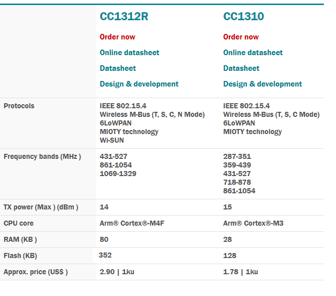

2.What is the difference between CC1310 and CC1312R?
  If you have the summary page for it, please let us know.
Nomo
    1. Minimum data rate for CC1310: 1.2 kbps and CC1312: 2.5 kbps; there is no RF advantage with improved sensitivity by using a lower data rate for these two settings. A lower data can be set if required.
    2. The main delta between CC1312R and CC1310 is the RAM and FLASH memory:

    You could use a lower data rate 1.2 kbps than the preferred 2.5 kbps, but then the Tx / Rx on time would be longer and the current consumption would increase compared to using the 2.5 kbps rate.
