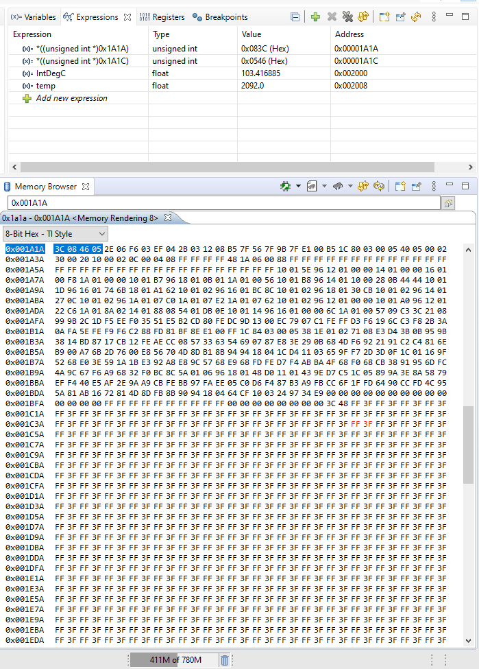

I'm using an LP-MSP430FR2476 evaluation board. When trying to use the calibration coefficients for the internal temperature sensor I'm seeing two issues.
1. The example code MSP430FR267x_ADC12_16 uses 85C for this calculation, while the data sheet specifies 105C. This is addressed in the linked ticket.
2. The coefficients stored in the part appear to be incorrect.

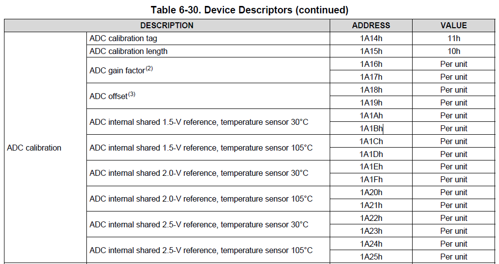

The datasheet specifies the follow locations for the temperature sensor.
Using these addresses and doing a memory dump produces:
Description Address 16bit
ADC internal shared 1.5-V reference, temperature sensor 30°C 1A1Ah 083Ch
ADC internal shared 1.5-V reference, temperature sensor 105°C 1A1Ch 0546h
ADC internal shared 2.0-V reference, temperature sensor 30°C 1A1Eh 062Eh
ADC internal shared 2.0-V reference, temperature sensor 105°C 1A20h 03F6h
ADC internal shared 2.5-V reference, temperature sensor 30°C 1A22h 04EFh
ADC internal shared 2.5-V reference, temperature sensor 105°C 1A24h 032Bh
The way the equation uses these calibration values is as y coordinates on the slope of the transfer function for the temperature sensor. This would mean the slope of the function is negative, but the ADC reading increases when temperature rises. What am I missing here? These values appear to be wrong, or the example code is using them incorrectly.

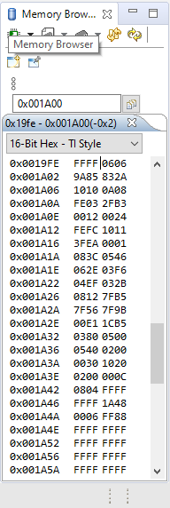

    2) For the ADC calibration coefficients stored in the Memory Browser, the data is stored in little endian (LSB first), so if you look at the data in 8-bit Hex - TI Style, it should make more sense.

  • I'm basically rewording the section 1.13.3.3 as I understand it. If i'm reading it correctly, the TLV values are stored in mV and are stored as the measured voltage at two temperatures, those two points are 30C and 105C.
    When I read the memory for 1.5V Reference i get the data below. If we use all decimal in the give equation, do you agree that 2108 and 1350 are the correct values based on the endianness and memory locations?
    ADC internal shared 1.5-V reference, temperature sensor 30°C 1A1Ah 083Ch 2108 decimal
    ADC internal shared 1.5-V reference, temperature sensor 105°C 1A1Ch 0546h 1350 decimal
    This indicates that the calibration value was lower (less mV) at 105C than it was at 30C. This is what doesn't make since. When I heat up the part, the ADCMEM0 value goes UP. So one would expect the 105C calibration value to be bigger than the 30C calibration value.
    The same document indicates in section 21.2.7.8 that the expected transfer function has a positive slope. Where the 105C reading is higher than the 30C reading. Unless I'm interpreting the calibration data wrong, the 105C value is less than the 30C value, which is wrong.
    With the example code the equation returns approximately 30C no matter whether the part is heated up or cooled down.
    If you plot the equation using CALADC_15V_30C = 2108 and CALADC_15V_105C = 1350. You get a negative slope.
    Is this macro somehow not reading the memory as expected? Seems that it matched the Memory Browser and the Expression Window.

    In regards to seeing temperatures at around 30 degrees no matter how much the part is cooled down or heated up, could you provide some test points / screenshots of the Expressions window at a high temp and cold temp? For instance, I see temp = 2092.0 and IntDegC = 103.41 in the screenshot, what temperature was this test with?
  • Hi Aaron,
    Thanks for the help. These are the captured values. Can you demonstrate the calculation?
    Calibration Values: 30C = 2108, 105C = 1350. All values in decimal

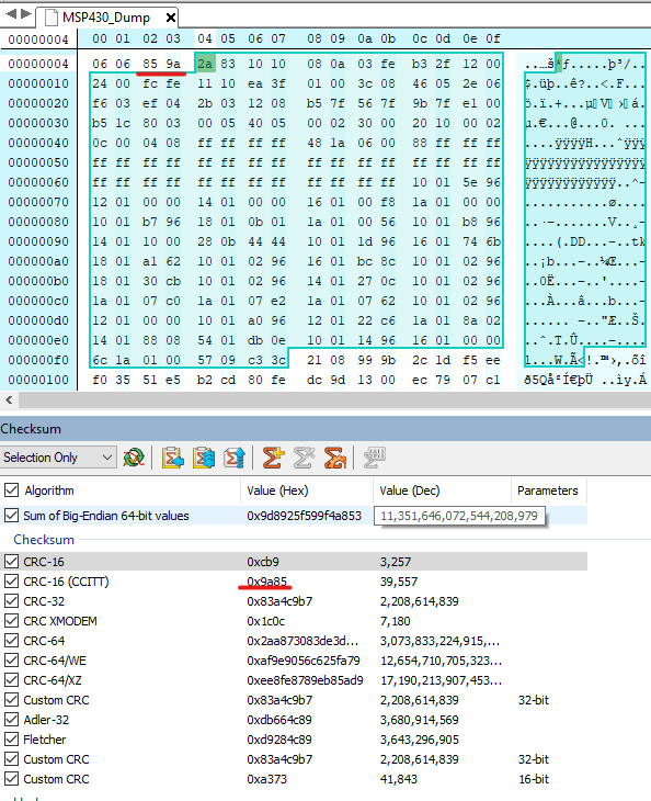

    There appears to be a problem with your correction data. Have you checked the CRC for the TLV data to verify it is correct?
  • David,
    Agreed. Your calculation and example confirms how I expect the calibration values to be interpreted and the equation to work. So it does seems like my calibration data is wrong on this unit.
    I believe however my data set passes CRC check.
