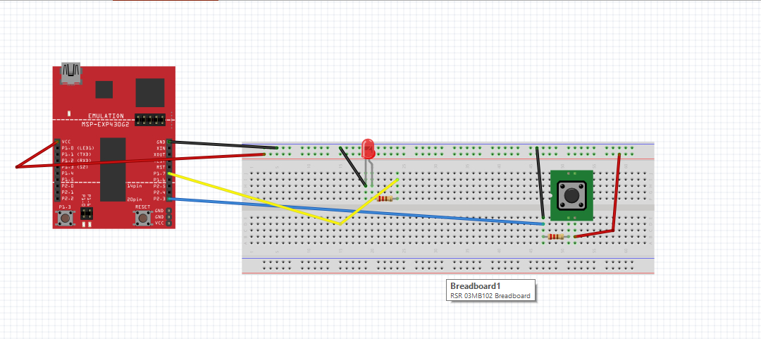

I've just began using the MSP430F5529LP. I'm trying to interface a button (tactile switch) with my MCU to power on an LED. However, whenever I push the button, I get a "USB malfunctioned error" from my PC. Any help regarding why this is happening and how to solve the problem would be very useful.
P.S. For the real life cct, I've connected my LED to P1.3 and the button to P2.3 and I'm making use of the 5V and GND pins to power the circuit.
Attached below is my code and a Fritzing sketch showing how I created my circuit:

Here is a screenshot of the fritzing sketch:
  • Hi Akoji,
    Don't use the 5V rail.  Use the 3.3V rail.
  • Thanks, Dennis.
    I realized I made a terrible mistake in using the 5v and GND pin of the FET. Having corrected this, I noticed that whenever I push the button, the green led on the USB hub blinks and not my original LED. Could it be that the board has been damaged???
  • Hi Akoji,
    Are you in debug mode when this happens?  If so disconnect the launchpad and reconnect and push the button.  Green LED blinks?
    If you forget about the button for a moment and modify your code so it only blinks the LED, does that work?
    Next put the MSP430 into low power mode just after disabling the WDT as shown here.
    When you push the button does the green LED blink?
