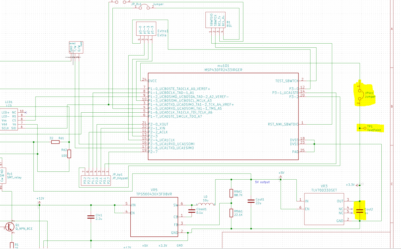

I wrote firmware for a certain project of mine using the Launchpad of msp430fr2433. Now I want to design a custom board that just has the micro and can be programmed using the launchpad.
I designed the board and made manual connections with the required pins and connected them to the J101 on the launchpad. I have attached the screenshot of the schematic to this message. When I try to program it, CCS say's "Error connecting to the target: Unknown device". I checked and see that the micro PIN 24 is getting 2.8V. The UART TX line P1.4 is at 3.3V. Seems like the micro is getting the power. Not sure why it's not able to communicate.
I connected SDWTCK, SBWTDIO, P1.4, P1.5, 5V, and Gnd. I also pulled SBWTDIO high with a 47K resistor (Not on the schematic). Still no luck. What did I do wrong? Did I miss something?
From my understanding, Launchpad uses BISPI to program the micro. I just have to connect SDWTCK, SBWTDIO for this to work. But got the same error.
  • I'm wondering why you're getting 2.8V out of the TLV70033. Are you fairly certain your 5V rail is really +5V?

  • Yes. I checked the voltage at the output of the 5V regulator and the input of the TLV70033. It is solid 5V. No problem here. I measured voltage at pin 24 of the micro, I got 2.8V. But the UART TX line has 3.3V. Not sure how?
    No. The board is power by connecting to a 2 pin connected. You need at least 5V there since it's connected to a 5V switching regulator. I don't have access to the power pin of the micro. Can't give it 3.3V directly.  The datasheet says it needs a minimum of 1.8V. We are well above the minimum right?

  • The MCU will run down to 1.8V (it needs 2V to start up). But the programmer is running at 3,3V, and may be objecting to not seeing 3.3V on the SBW pins. More generally I'm just concerned why the regulator isn't working properly.
    If adding a cap is too chancy, try slowing down the JTAG first. As I recall there's also an option nearby for setting the target voltage; I'm not sure this works on a Launchpad, but you can try it. If it works, this wouldn't adjust the actual Vcc, but would tell the programmer to look for a different voltage.
    The TXD=3.3V is a bit odd. It looks like it is also connected to LC01(?), which is powered from +5V. I suggest you disconnect the RXD/TXD wires for now; they aren't necessary for SBW programming.

  • I'm still trying to understand how you're getting 5V out from 5V into the TPS560430. Its data sheet (Sec 7.3) claims the most you can get is 0.95*Vin.
    I don't want to be the one to tell you to damage your board, but the voltage discrepancy seems like the most likely suspect.

    I double-checked again. I supplied exactly 5V via DC power supply, I got 4.98V at Cout1. The capacitor might be smoothing it.
    I tried to solder a wire but ended up ruining 2 boards out of 3. I'm making another batch of 3 with some revision for better testing. I included a jumper and test point between Vcc of micro and Vout of 3.3V regulator. If required, I can connect regulated 3.3V from the launch pad directly to the Vcc of the micro. I have attached a screenshot of this.

  • Hello
    I just want to double-check before I compete for the schematic for my second board. One document said to pull TDIO high via 47K ohm resistor. Another document says to connect the Test pin (TSBWCK) to Vcc. I have attached a screenshot of this.
    Could you please confirm my following assumption?
    Connect SBWCLK to Vcc without a resistor (Which doesn't make sense to me. We are ruining clock)
    Pull up TDIO with 47k ohm resistor.
  • I think this description is trying to tell you how to disable SBW, which is a rather rare thing to want to do.
    I would instead follow the data sheet (SLASE59D) Table 4-4 recommendations: 47K pullup on RST, TEST open (internal pulldown).
    That said, what I would suggest is that you start a new thread ("Please review my schematic" or some such) with an image of your schematic and your question(s) about the SBW pins (and maybe the regulators?). You can also include a link to this thread -- or create it as a "Related Question" -- for those interested in the history.
