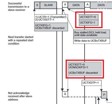

I am currently testing the UsciB in I2C mode, it seems that the peripheral does not behave as described in the manual.
Nor as described by others in this thread:
"e2e.ti.com/.../253933
I deliberately used the wrong address to test how the peripheral would respond.
As can be seen there is no ack on the 9th clock pulse, just some minor cross talk:
Looking at the code, it looks like this:

The yellow area was added to debug what I have noticed...
According to the manual, at least my interpretation of it, the UCNACKIFG should be high directly after UCTXSTT has gone low:
However when running the code I see that interruptFlagsFirstPass has the value 0x0002 and interruptFlags gets the value 0x0022 after going through the loop (at least) 4 times....
The NACK signal seems to be delayed...
I would prefer to solve this without using the loop, since I don't like the dependency between the speed of the cpu and the speed of the peripheral...
Hope that someone can help me further.

  • The thing that seems odd to me is that the I2C unit is presenting UCNACKIFG before you've put anything into TXBUF. Until then it won't release SCL ("stalled"), as seen in your scope trace. Until it releases SCL, there is no NACK.
    I suggest you store something into TXBUF, then read the interruptFlags.

    Breaking at the return interruptFlagsFirstPass is 0x0002, interruptFlags = 0x0022, as such when UCTXSTT goes low the UCNACKIFG hasn't been updated yet.
    Note that I also tried two locations to write to the transmit buffer of the peripheral, the behavior did not change.
    The signals on the oscilloscope image are the same as before:
