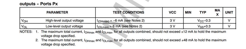

Could you please help me with the below two questions asked by My customer? Thanks!
  • as the below figure shown, what's the meanings/difference of "note1" & "note2"?

  • Hi Rayna,
    1. For the datasheet download from website, there is only note 2. That means, the total output current for all GPIO should not exceed +-48mA, in order to meet the VCC-0.3V, VCC+0.3V spec.
