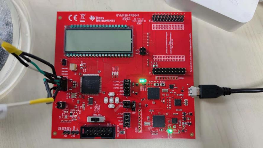

I built a platform as same as the one in the Application Report “Liquid Concentration Sensing” (the same 2MHz transducers and 3D printed fixture) basing on  EVM430-FR6047. (Figure 1).

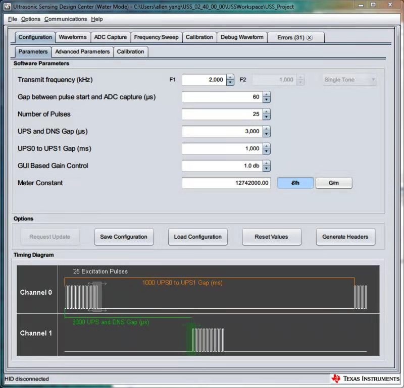

Then I connected the EVM and set the parameters on the USS according to the user's guide "SLAU810B". (Figure 2)
I set the "Transmit Frequency" F1=2000, the others parameters were kept default value. (Figure 3)

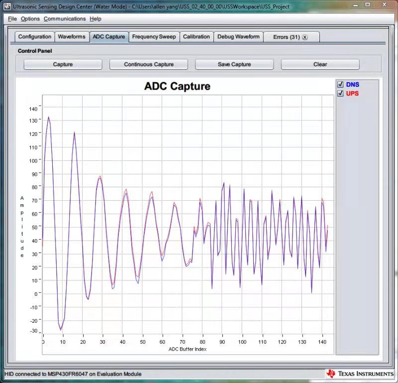

But my ADC capture is abnormal. (Figure 4)
I had tried the way in Chapter 4.3 of SLAU810B, but the ADC Capture didn't change.
I browsed other posts in the E2E forums and didn't find the same problem as I did. It's the first time I use this application. Could you give me some advice to improve the ADC Capture.

    If you are using the 3D printed pipe from the app note, Liquid Concentration Sensing, https://www.ti.com/lit/pdf/slaa973, you need to make sure you are using the configuration parameters consistent with that water pipe. Please see the configuration in Figure 2-3. GUI Configuration in the above app note. It suggests
    Gap between pulse start and ADC capture  (us) = 26
    Number of pulses = 18.
    GUI based gain control = -2.3 dB
    You should start with those parameters, and then follow the guidelines from the Quick Start guide (https://www.ti.com/lit/slau810).
    Most likely, with 60 us for Gap between pulse start and ADC capture (us), you are starting the capture after most of the signal is already attenuated.
