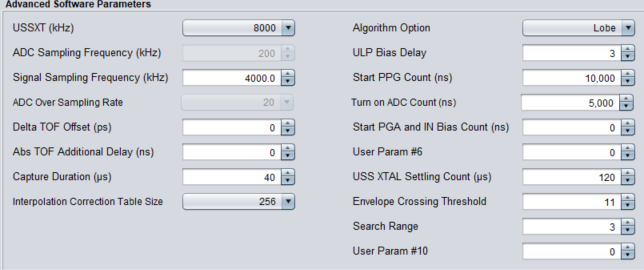

    My actual settings in the USS are:
    Number of pulses = 25
    PS and DNS Gap = 3,000
    UPS0 to UPS1 Gap = 1,000
    and advanced:
    Do I understand you right that my UPS0 to UPS1 Gap has to be greater than what I calculated for the whole time of the period shown in the diagram? I calculated 987,531 ms for my cycle time. So it should be ok but close to the maximum.
    For the calculation I just changed the value for the Upstream/Downstream Gap of the diagram to the 3us that I sat in the USS.

    For these settings, you should not be getting that error "Time between measurements is greater than UPS0 to UPS1 Gap".
    Actually, you do not have to count that Sleep (LPM3) 985 ms. Your settings are ok. I am not sure why you are getting that error. One possibility is that it is not finding any ADC signal when it hits that error. Do you know if that is happening?

    The UPS-error likely appeared with errors that no signal was detected. I often had an empty pipe. So this should be the problem and I will ignore further errors in this case.
