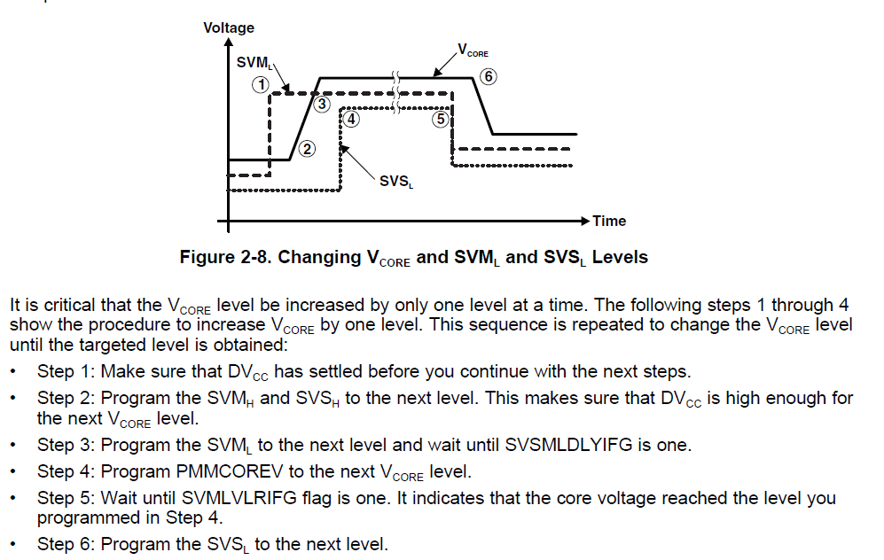

  • Hi Dwight,
    so far TI is not aware of any cold start-up problems on these devices to better understand the phenomena we need some more details. First point I want to make here is that Vcore cannot be increased to 3.3V. I think you mean you increase it to Vcore level 3 to later on support 24 MHz and you do this at 3.3V DVCC supply correct?

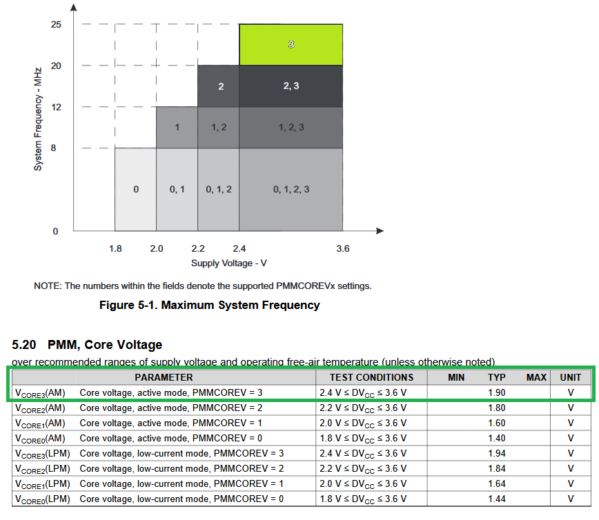

    Finally you want to run the core LDO at around 1.9V to cover the green marked operating mode correct?
    This must be done step by step with respect to SVSH and SVSL increasing together as described in the user guide.
    Normally this Vcore increase is done by a TI driver function. Now to my questions:
    1. Do you use the TI driver to do this? Can you please post the Vcore increase code?
    2. Do you have an idea where in this Vcore increase functions it hangs? Maybe you can add a scope probe to DVCC and Vcore in good case you should see the step by step increase and then you can post good vs. fail to get an idea what goes wrong.

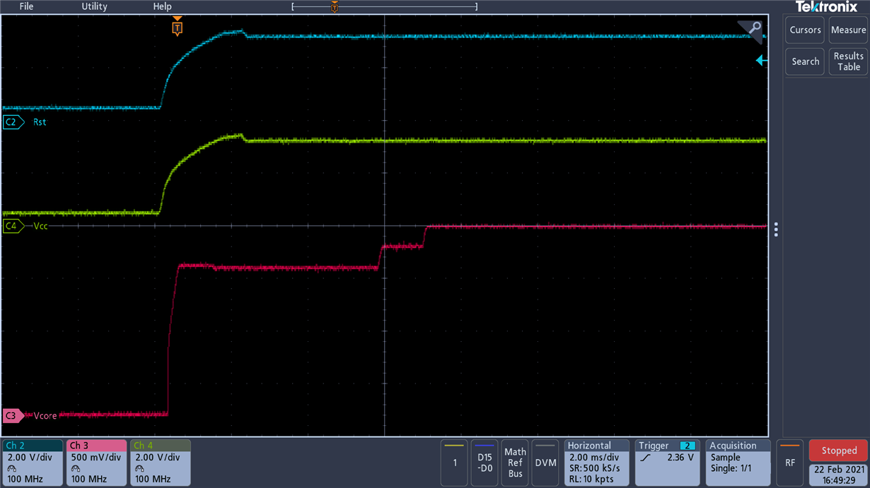

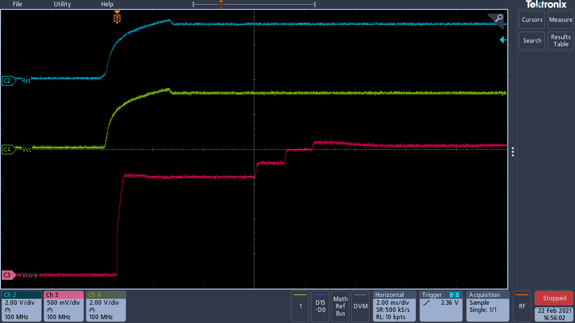

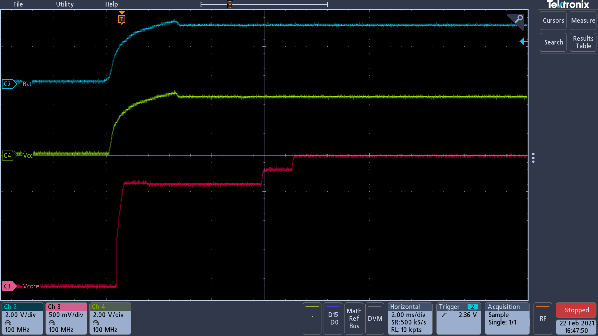

  • Yes the Vcore is set to 1.9V so that we can run at 24MHz.
    Startup code included.

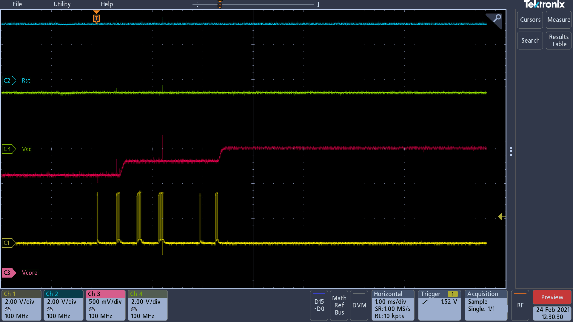

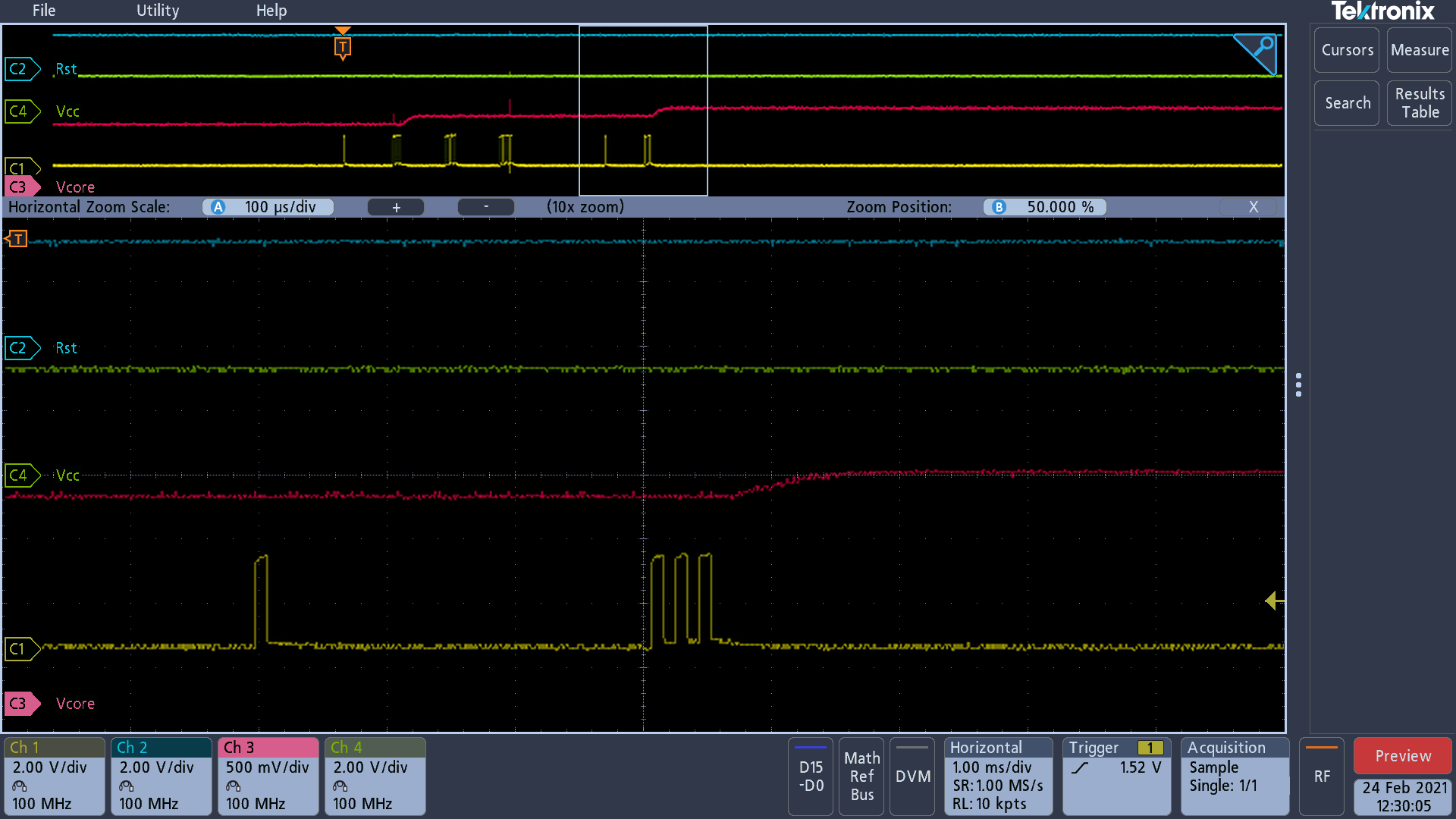

    We will attempt to probe the parts in the cold chamber to see where it hangs.

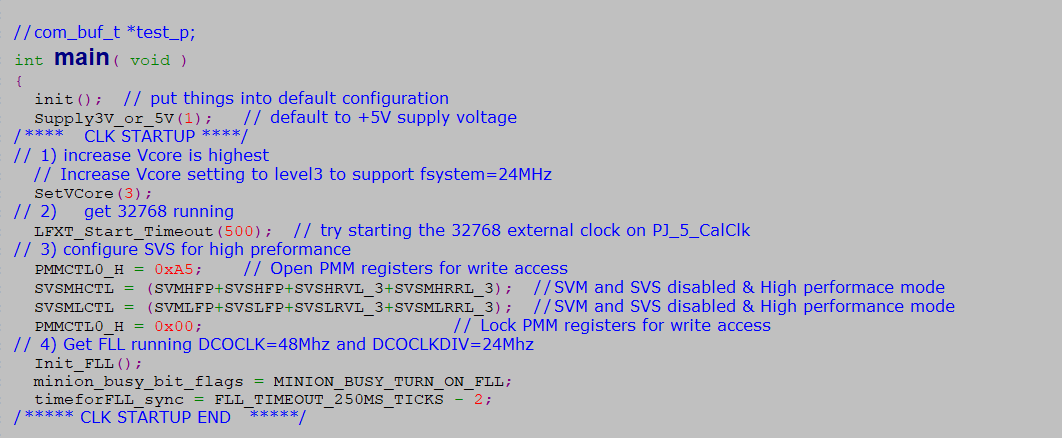

    here is a picture of the what we do from the start of main… the init() function disables the watchdog and initializes ports (I can share that code it they would like) and the Supply3V_or_5V(1) function is selecting the voltage level on DVIO pin for the MSP.  Our circuitry can regulate DVIO to either 3.3V or 5V.

      // Set SVS/SVM high side new level, with full performance mode
     // SVSMHCTL = (SVMHFP+SVSHFP) + SVSHE + SVSHRVL0 * level + SVMHE + SVSMHRRL0 * level;
      // Set SVM low side to new level, with full performance mode
      SVSMLCTL = (SVMLFP+SVSLFP);  //High performance mode SVM and SVS disabled
     // SVSMLCTL = (SVMLFP+SVSLFP) + SVSLE + SVMLE + SVSMLRRL0 * level;
      // Wait till SVM is settled
     // while ((PMMIFG & SVSMLDLYIFG) == 0);
      // Clear already set flags
      PMMIFG &= ~(SVMLVLRIFG + SVMLIFG);
      // Set VCore to new level
      PMMCTL0_L = PMMCOREV0 * level;
      // Wait till new level reached
      if ((PMMIFG & SVMLIFG))
        while ((PMMIFG & SVMLVLRIFG) == 0);
      // Set SVS/SVM low side to new level, with full performance mode
    //  SVSMLCTL = SVSLE + SVSLRVL0 * level + SVMLE + SVSMLRRL0 * level;
      // Lock PMM registers for write access
      PMMCTL0_H = 0x00;
    #endif
  • Dwight,
    so far so good you're using the DriverLib function to increase Vcore which is good. Do you know which version of the DriverLib you use? Where there any changes on your site?
    If I got it right you're pretty sure the problem appears in the "SetVCore(3)" call right? So you can exclude the LFXT start function, the SVS config or the FLL init?
    To confirm this I want to see the Vcore steps on a scope to see that it really goes trough all the 4 Vcore levels correctly. Also a port toggle after the Vcore increase would be a confirmation that it works.
    You mentioned the DVIO option; did it make a difference if you power DVIO with 3.3 or 5V?

    Sorry for the slow responses.   I work for Arrow and am supporting an end customer.  They recently informed me that the problem went away when they got parts from a newer Lot code.  I have submitted those Lot code numbers to the internal support people.
    Here is some more feedback from the customer.
    I’m pretty sure it gets stuck in the SetVCore(3)… But have not verified that with a scope and port pin like described by Dietmer… Again, this all happens at -40C so I will need to have cabling outside the chamber to capture Vcore steps etc.
    The way that I know it was in the SetVCore(3) function is that my code associated with the crystal startup and FLL has timeouts in the code that would force a reset.  We never get a reset and the SetVCore(3) was the only code that has while(1) loops with no timeouts.   Our latest code revision does have timeouts in the SetVCore(3), that did help but we still have some number of units failing, even though the system resets over and over again.

  • Ok have the captures....
    1) Good_-20C.png is the capture of the unit-A at -20C... this did not have the power up issue.  Note: was good at hot, 25c, -10c etc.
    2) Bad_-30C.png is the capture of the same unit-A at -30C.... it never recovers stays looping waiting for the Vcore to make the last step.  Note: I don't have the timeout in the while(1) loop... so have the original operating system where it loops forever.  However, if I did have the timeout this unit would still not recover.

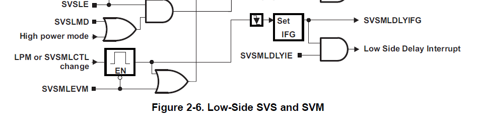

  • Hi Dave,
    thanks a lot this helps significantly. As you can see in the fail plot Vcore stops at Level 2 and is not increased to Level 3.
    However the Vcore level 2 looks good from voltage point of view. What concerns me a bit is the dip at -20 degC on Vcore level 3.
    Another problem I see at -30 degC picture is that the GND level of DVCC and RST is not GND so do you have something floating here?
    Looks like GND is lifted. Do you have maybe condensates humidity on the board causing leakage paths.
    I think this is the problem why Vcore does not go up and hangs in one of the SVSH IFG check loops because your main supply looks not healthy.
    Interestingly the GND level of Vcore looks ok!
  • We have capacitance that takes some time to bleed off.... The capture that I sent I didn't delay long enough for those supplies to bleed off.
    Here is a capture where I powered off the system, gave it time to bleed off and powered it back on.
  • Dave,
    thanks this looks better but behavior still appears so powering up not from 0V can be excluded as the root cause thanks!
    One more thing the SetVCoreUp function has several while loops where it might go stuck and where you implemented time outs
     line 49 - waiting on SVSMHDLYIFG after enablign SVSMH and SVSHand set new SVSHMHRRL level
     line 71 - waiting on SVSMHDLYIFG after recover old settings if VCC was too low
     line 95 - waiting on SVSMHDLYIFG after SVSHRVL0 to new level
     line 116 - waiting on SVSMHDLYIFGafter enablign SVMLE and SVSLE and set new SVSMLRRL0 + SVSLRVL0 level
    line 152 - waiting on SVSMHDLYIFG and SVSMLDLYIFG
    So because you have a pretty reproducible setup can you please implement port toggles at each stage (1 toggle, 2 toggles 3 toggles,.....) to see at which while(1) it seems to get stuck would be interesting if it is the high or low site delay flag. This would help to look at the exact code location of this function.
    I assume you have checked all the existing PMM ERRATAs on this device which are related to SVSH and SVSL?
  • I've added the port pulse to identify specifically which while(1) loop we get stuck.  Attached is the capture, looks like it is hanging as we are working on level 2.  Here is the code where it is getting stuck ....  I've attached the capture, the second capture is zoomed in on the failed event.
    // Clear flag
    PMMIFG &= ~SVSMHDLYIFG;
    // Set SVM, SVS low side to new level
    SVSMLCTL = SVMLE | (SVSMLRRL0 * level) | SVSLE | (SVSLRVL0 * level);
    // Wait until SVM, SVS low side is settled
    #if 1
    Core_time_counter = 0;
    __delay_cycles(120); // about 5 u seconds
    while ((PMMIFG & SVSMLDLYIFG) == 0) {
    if(Core_time_counter++ > VCORE_LOOP_DELAY) // timeout delay
    WDTCTL = 0; // something not working force a Reset to the RTC system
    /*TESTING BEGIN REMOVE */
    // toggle 4
    P6OUT |= P6_5_RES_GND;
    P6OUT &=~ P6_5_RES_GND; // low
    /*TESTING END */
    #else
    #endif
  • Dave,
    thanks for the experiment, very helpful. This shows us that the part is hanging in the loop waiting on the SVSML delay to expire but obviously it does not. Because RESET and SUPPLY are stable at this time PMM26 existing on some older F5xx devices can be excluded.
    The delay is implemented to mask voltage settling on the supply voltage supervisors during power mode change or access on SVSMLCTL access as shown in the user guide. The length of the delay depends on performance mode (full is ~12.5 us) and normal is around 100us - 150us. You use the normal mode which is ok to consider PMM14 errata.
    It is also that the device not goes stuck because you time out function works if used which really means to me that the delay flag is not set OR the delay is never triggered. What really wonders me is that the delay works at higher or normal temperature and also at the increase from Vcore 0 to 1.
    This tells me the delay and the trigger circuit should work! I also triple checked the ERRATA and my history but can confirm we never have seen this on any F5xx device.
    Can you please double confirm on how many units (absolute and relative) you can see this behavior?
    So to take the next step can you please provide the disassembly view of the code portion above to review it for any obvious anomalies?
