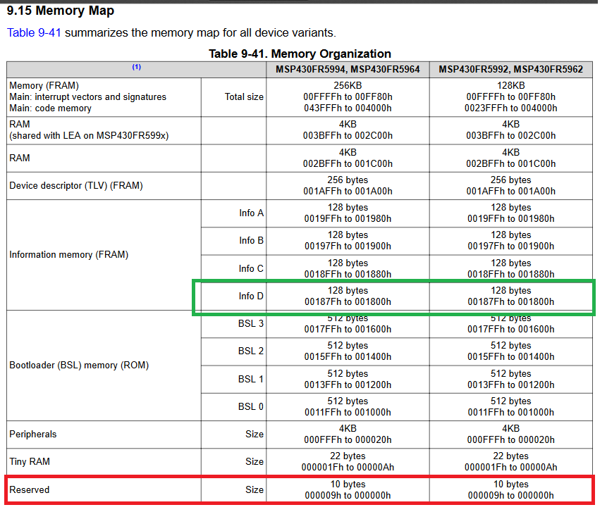

Hi Team,
Reaching out to you as our customer wants to know the supposed value and purpose of the reserved memory of the MSP430FR5994. The memory address is given on section 9.15 of the datasheet.
Can you also tell us possible implications of overwriting this reserved memory? Would this lead to an error?

  • Hi Jejomar,
    you refer to the reserved memory at 0x0000 - 0x0009 right? This area of the memory is ROM so you cannot overwrite it at all.
    At this region a hard coded bis  LPM4,SR is coded to have somewhere a fixed CPU instruction having the possibility to bring the device into a safe state.
    Depending on MPU settings you might trigger access right violations here.
    So finally recommendation is not to write at this memory area.

  • Nicolas
    so what are the absolute addresses of the data you provided?
    If I get it right it is as following (pls correct me if I'm wrong)
    @1802
    30 31 32 33 34 35 36 37
    @180A
    38 39 41 42
    @180E
    00 2C 01 D0 07 00 00 00
    This memory area is in Segment D of the info memory and does not belong to the reserved memory area you asked before. So please help to clarify what you really looking for?

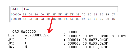

  • In a working device we have 0x32 0xd0 0xf0 0x00 0xff 0x3f 0xff 0x3f 0xff 0x3f as reserved memory.
    Could it be that the start pointer didnt´t point to 0x0000 but instead to 0x1800 and that is why we got that reading of the INFO memory data?
    Nicolas Wödy
  • This is the content I expect to get from these addresses! You can see the 0x3FFF which represents the jmp $ and the first addresses (0x0000  is missing) represents the hard code bis LPM4,SR.
    No idea why on the failing unit you get that garbage data but finally it is a looks like a counter value goes from 30 upwards. Do you have this kind of code or data somewhere in your code?

  • Its not a counter, this sequence is hardcoded to the start of INFO at the moment. Later it is supposed to work as a product code.
    today I read the reserved memory on a FR5994 RevC and show below how it should look like. This memory area is ROM (read only) and cannot be written.
    So if you code reads data incorrectly from these addresses something is wrong with the device.
    As said please perform a simple LPM4 bench to check if it is drawing high current.
