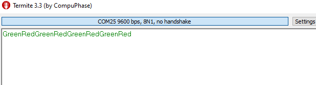

  • Hi Misha,
    I ran your original code on MSP430F5529 launchpad and it works in CCS.  The serial communication uses the back-channel UART connection to the programmer/debugger.  I had to use CCS because for some unknown reason after I installed Energia it gives me errors about the programmer firmware needing updating and I honestly can't figure out how to do that from Energia.
    Here is snapshot of my terminal app receiving the messages:
