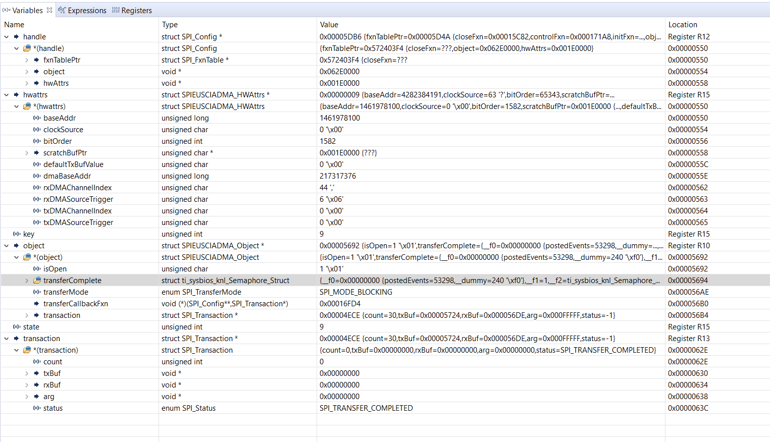

I am trying to have an SPI communication setup between MSP430FR5994 (Master) and CC1352R (Slave). I am trying to replicate the SPI example given in the TI Resource explorer/TI Drivers of CC1352R. The CC1352R master and slave example works for me on two CC1352R boards. Now, I want to replace the CC1352R master with the MSP430FR5994 master. And I think I have some configuration issues, I suspect halHwi1Params.arg = 3. My application stuck when the SPI_transfer is in progress.
Compiler version - 16.9.11.LTS
TI-RTOS version - 2.20.0.06
XDCTools version - 3.32.0.06_core
My configuration -
var halHwi0Params = new halHwi.Params(); halHwi0Params.arg = 0; halHwi0Params.instance.name = "halHwi0"; halHwi0Params.priority = 1; Program.global.halHwi0 = halHwi.create(48, "&UARTEUSCIA_hwiIntFxn", halHwi0Params); var halHwi1Params = new halHwi.Params(); halHwi1Params.instance.name = "halHwi1"; halHwi1Params.arg = 3; halHwi1Params.priority = 3; Program.global.halHwi1 = halHwi.create(24, "&MSP_EXP430FR5994_isrDMA", halHwi1Params); var halHwi2Params = new halHwi.Params(); halHwi2Params.arg = 4; halHwi2Params.priority = 5; Program.global.halHwi2 = halHwi.create(32, "&GPIO_hwiIntFxn", halHwi2Params);
And in msp430fr5994.c, MSP_EXP430FR5994_isrDMA looks like this
* =============================== DMA ===============================
* ======== MSP_EXP430FR5994_isrDMA ========
* This is a application defined DMA ISR. This ISR must map and call the
* appropriate Driver_event(handle) API to indicate completed DMA transfers.
Void MSP_EXP430FR5994_isrDMA(UArg arg)
/* Call the SPI DMA function, passing the SPI handle used for WiFi */
SPI_serviceISR((SPI_Handle) &(SPI_config[0]));

transferOK = SPI_transfer(masterSpi, &transaction);
sprintf(uartStr, "%d", transferOK );
UART_write(uart, "transfer ok = ", sizeof("transfer ok = "));
UART_write(uart, uartStr, sizeof(uartStr));
