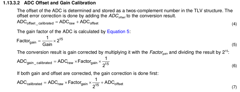

I'm attempting to calculate a gain-corrected ADC value using the MSP430FR2676. The User's Guide outlines the following calculations:
The datasheet indicates the Gain factor is in memory location 0x1A16. The value read at that address for my specific part (a CAPTIVATE-FR2676 development board) is 16357. When I perform the calculations as described with an assumed ADC reading of 2048 (mid-range at 12-bit resolution), the result is 0.12520633367977 which is not correct. The calculation as performed is detailed below:
The data type of the gain value is not explicitly defined, though it is for the offset error correction value. However, I cannot see how a data type difference would improve the situation.
What is it that I'm missing? Any help would be very much appreciated.

  • It occurs to me that the MCU on this development board is actually an XFR2676. Is it possible that this experimental MCU does not have a valid gain factor? We have prototype boards for this product coming in a couple weeks and I can re-test then, but some confirmation here would put my mind at ease.

  • Hi JD,
    Yes, it is possible that the X silicon does not have valid gain factor programmed.  I don't have specific information on this device, but full device parameters are not guaranteed on the X silicon.  I would recommend testing with the proto boards you have coming and let us know if you see something similar.  Another option could be to order a couple sample ICs, which you can get in a couple days, and populate on the development board if you have the capability to solder a new device.
