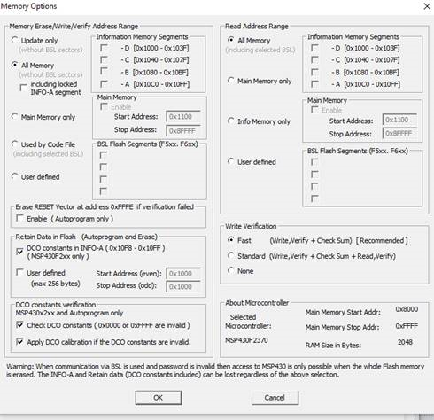

A problem has occurred in production with devices on which the MSP430F2370 is installed. The internal DCO constants seem to be completely off. The devices are RF devices, which initialize the RF chip via the internal DCO. If the initialization goes wrong, the application in the device will not start. Now we have a batch of devices where 30 out of 60 devices did not start.
However, flashing the devices via JTAG went as usual. We use the Elpotronic FlasPro 430 or the Elpotronic GangPro 430 for flashing. The following is set there:
We have now opened the devices and flashed them via BSL. Now the devices are running. 2 devices, however, I do not get to run, there the DCO verification fails repeatedly.
Do you have an idea what this could be? Was there possibly a faulty batch?
