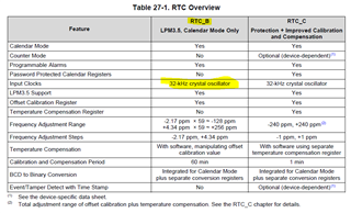

Reading user guide of MSP430FR5969 it seems to me that the only RTC_B clock source is LF crystal;
No possibility to source from ACLK or MCLK...
Does anyone know if am I right?
Thank you

The reason the RTC clock is sourced directly from the low-power 32Khz oscillator is when operating in LPM3.5, all clocks, including ACLK are disabled. There is no provision to select a different clock source for the RTC.
