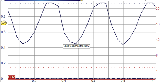

  • Wow, I've been scouring the forum to find a solution to an SD16 conversion instability problem all afternoon, and I just came across this post.  I had two voltage dividers set up to give me a reference voltage and a sample voltage based on the MSP430FE4272 reference voltage, and the SD16 was giving me outputs that varied by around 2-4000/64000!
    After reading this I hooked up the scope to look at the reference voltage.  Here it is:
    That's right!  .4 V swing p-p on a .8 V signal.  It has a 339 ns period, meaning 3 MHz. I'm not sure where this is coming from, MCLK maybe?  I'm using the default clock settings, so it appears that it is running from DCO, whose default range is .65-6.1 MHz, and I guess that it is in the middle of that range.
    Anyways, after adding liberal .1 uF electrolytic caps to my voltage dividers my variation is down to around 20-40/64000, which is within the range of the datasheet and totally livable.
    So, to the next person that is getting rapid variations in ADC readings: try liberal use of coupling caps.  Now I understand why the old timers are so obsessed with them.
    Now can someone tell me a more efficient way to choose capacitors for my circuit board, or should I just throw a bit cap at every signal and power port?
