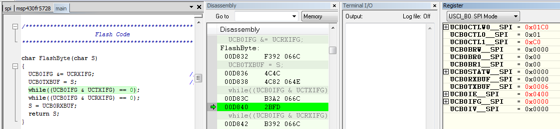

The first problem faced is that, when attempting to use either of the following two lines of code, the project is stuck and unable to progress any further:
while ((UCB0IFG & UCTXIFG)== 0);
while ((UCB0IFG & UCRXIFG) == 0);
When I remove the “UCB0IFG” the code can run, however then I face a significant problem. The MSP430FR5728 fails to read anything from the N25Q00AA, and always outputs “0” when I attempt to print any values read.
The following is the code that I use when trying to Read the Status Register.
char FlashByte(char S)
UCB0IFG &= UCRXIFG; // Clear RX Interupt
UCB0TXBUF = S; // Write Byte
while((UCB0IFG & UCTXIFG) == 0);
while((UCB0IFG & UCRXIFG) == 0);
S = UCB0RXBUF;
return S;

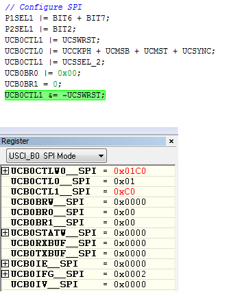

// Configure SPI
UCB0CTL1 = UCSWRST; // Enabled
UCB0CTL0 |= UCCKPH + UCMSB + UCMST + UCSYNC; // 3 pin, 8-bit SPI mode?
UCB0CTL1 |= UCSSEL_2; // SMCLK
UCB0BR0 |= 0x00; // /2
UCB0BR1 = 0; // 1 MHz, 9600 Baud Rate
UCB0CTL1 &= ~UCSWRST;

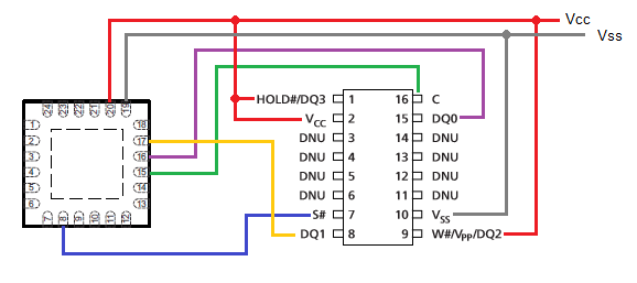

I will also attach a diagram detailing the connections I have created between the MSP430FR5728, and the N25Q00AA., which can be seen below:
I feel like if I could just be able to properly read the status register, I can then progress to the next step of trying to write to and read from the N25Q00AA without significant difficulty. If someone could help me to figure out what I am doing wrong, I would greatly appreciate the help
