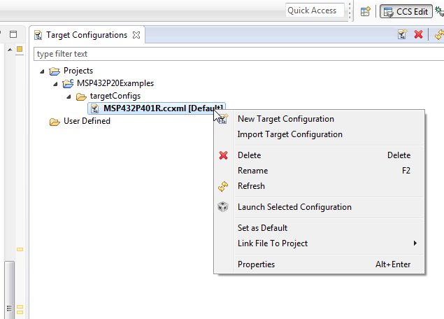

    Now, replace the jumpers as they were and open CCS. Go to the View Mnu and click "Target Configurations."
    In that tab, expand any MSP432 Project, and right click on the Target Config .ccxml and click "Launch Selected Configuration".

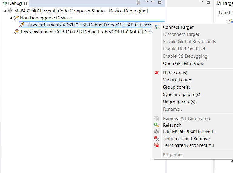

    Right Click on anything in the Debug tab, and click "Show all cores."
    Expand "Non Debuggable Devices".
    Right Click the CS_DAP Debug Probe, and click "Connect".
    The "(Discconected)" next to the probe should go away. If you recieve an error here, follow its instructions to update the the XDS firmware, then repeat the above steps to get back to this point.
    Now, click on the Scripts Menu, and you should be able to use the Factory Reset now.
