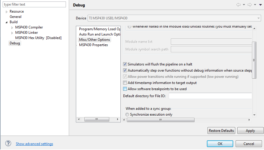

  • Good Morning,
    The original problem "MSP430: Trouble Setting Breakpoint with the Action "Continue or Finish Stepping" at 0xc53a: Address is past the end of memory" can temporally fixed by disabling the Software Breakpoints in CCS. Uncheck "Allow software breakpoints to be used". We are currently working on an update for this behavior.
    The batch file for downgrading (V3V2) the MSP-FET430UIF will not work with the MSP-FET (Black color). The batch file (V2V3) is only legacy, CCS is doing the update from V2 to V3 of the driver. This file will be removed in newer versions.
    Florian

  • thanks for the workaround Florian...good to hear TI has the problem in hand.
  • yes...but i am limited to 3 breakpoints. Not a complete train smash at this stage, but it is irritating to have to constantly change locations.
  • I always have to turn software breakpoints off in IAR too (unless in simulation mode)
    G2553 only have one breakpoint, but you can hopscotch with it.

  • Just chiming in with "me too" on this issue, but with an extra scenario that may be of interest, and if not part of the root cause, is a separate bug in its self.
    Firstly though, I confirm, disabling software breakpoints does work around the problems previously mentioned by others.

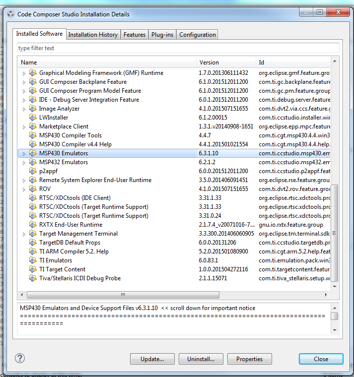

  • Hi All
    I have just set up ccs 6.1.0.00104 (as per help/about)...interestingly on installing it said ver 6.1.1.00015 & yes its the version currently available off the TI site....on a win10 installation running under vmware on a mac. That all works which is quite interesting in itself for those upgrading to win10.
    i ported my projects (the EMETER project plus my own one) over to the win10 machine & yes it was a mission getting the projects to build due to all the different paths.
    I took my FET from the win7 machine & connected it to the win10 machine and started a debug session . CCS then said it needed to 'update' the FET which i let it do, and after that I continued on to debug without any issues whatsoever!!!...so this earlier version of CCS is just fine for debugging.
    I then took that same FET with the 'upgraded' flash back to the win7 pc (which has ver 6.1.1.00022) and reconnected it and started a debug session. Sure enough CCS said it needed to 'upgrade' the FET, BUT, i clicked on 'ignore'. BUT, despite that i STILL got the error relating to the breakpoints....
    Akash please note that 6.1.0.00104 (or 6.1.1.0015 i'm still confused about the numbering) does work fine as you found on March 2nd above...so it really does appear to be something in the 6.1.1.00022 release that is the problem.
    AND:
    1. is there any way to downgrade the CCS from 6.1.1.00022 to the 'upgrade' before that one?
    2. why did the installation i did on win10 initially indicate 6.1.1.00015 but in help/about it shows 6.1.0.00104?
    cheers
    moshe

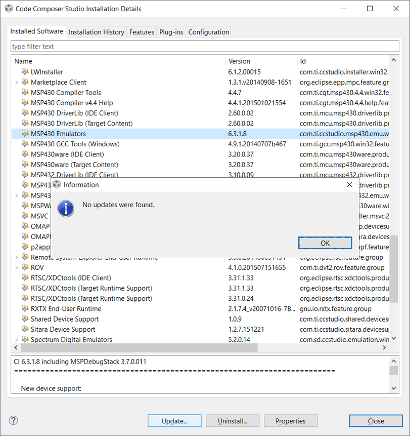

  • Hi Trevor,
    The MSP-FET firmware updates are related to which version of the MSP430.dll is being used by the application. I suspect the reason you get an update every time you switch between applications (CCS and MSP430Flasher) is they are using different DLL versions. If you go into the install directory for each of those applications and find the MSP430.dll it uses, you can find the version information in the DLL properties.
    This is expected behavior, and can be removed by determining which application has the newest DLL version, and copy/pasting it to the other application. I recommend creating a backup copy of the old .dll somewhere just in case you run into issue so you can restore if necessary. We (TI) won't guarantee that you can always swap between dll versions like this, but for this particular case, you should be fine.
    Mike

  • Hi Mike
    Thanks for the advice - yes, the DLLs were different by one minor rev (two days). Updating the older one works (debugger still functions correctly in CCS)
    cheers
    Trevor
  • Hi Mike
    I think you have just nailed the problem!!
    i looked at the msp430.dll on my win10 installation (ver 3.4.3.4 of 2/5/15) vs the msp430.dll on the win7 installation (ver 3.7.011 of 17/2/16).
    i copied the dll from the win10 installation to the win7 installation and launched ccs on the win7 machine....

  • Florian,
    I'm still not seeing an available update to the MSP430 Emulators in my CCS Installation Details.
    Do you know when this will go live? Is it already supposed to be live?
    Below is a screenshot showing my current version, and the failure to find an update.

  • HI Moshe,
    Have you checked for updates in CCS6.1.2? The is an update for the MSP430 Emulators v6.3.1.10 This fixes the breakpoint issues.
    By the way the MSP430.dll always includes an firmware image of the MSP-FET. When CCS starts it checks if MSP430.dll and the firmware on the MSP-FET are in sync. If not an updates is requested. Due to this fact it can sync. with the MSP-FET.
    I have also attached a picture of my tested and working CCS version.

  • My MSP430 Emulators Version is 6.3.1.8.
    Search for Updates says "No Updates Found".
    How can i get the Update?

  • Hi Pedro,
    Just to let you (and others) know I had the same problem.
    I also got the trouble setting breakpoint Address is past the end of memory error.
    It seems that when you change your source code in CCS and rebuilt and had breakpoints already set this error sometimes occurs. I'm using the newest MSP-FET emulator/programmer tool.
    When I have this error I can get around it by removing all breakpoints (right click in the breakpoint window and select 'remove all'). Then rebuild if not done already and set new breakpoints. Now if I start debugging the error does not occur anymore (until I change the source code again).
    This error does however not always occur when you change your source code.
    Please let us know if this workaround also works for you. Needless to say that I still regard this as a bug.
    BTW: I am using the latest version of MSP430 Emulators dll (6.3.1.8)
  • Hello Florian,
    it works.
    Many Thanks,
    Andreas
  • This works for me too, though not the first time:
    A trap for people not used to CCS though : Inside the "Installed Software" list it's necessary to specifically select "MSP430 emulators" then "Update..." --- I was expecting simply clicking "Update..." to go and search for a list of all possible updates, then select from that list which ones I actually wanted. If you do click "Update..." without selecting anything you *wont* get a warning to say you haven't selected anything to update ... you'll just get a message saying there are no updates.
    (Florian / Mike ... perhaps this is what confused others previously including myself when there should have been an update available but people said they did not find one)
