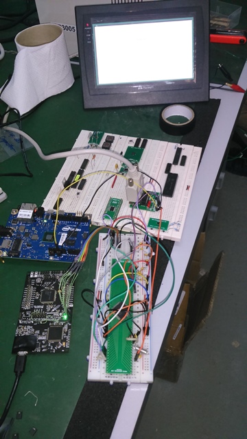

Hi Everyone,
I'm currently working with a MSP432 launchpad driving a HMI display using modbus RTU protocol via RS232.
The problem I encountered the past few days:
  • the built in DC to DC converter of the XDS110 gets burning hot from time that it is powered on.
  • Unusual hangups also encountered.
    hmi
    rs232
  • I used a MAX232 on P3.2 and P3.3 on these pins to convert the UART to RS232 level. The problem is I'm not getting the same echoed message expected. But the amazing thing, I have (2) subroutine that consist of reading the bit switch on the HMI panel and one is displaying the floating point number. If I use only one of them, things works fine but if im going to read the switch status and display a floating point number. both will not work.
  • The same code I used to Intel Galileo and it works fine even if the (2) subroutines are in place. That's why I am able to identify it is not with the coding. below is the copy of my tested code.

  • Leo,
    It looks like your MSP432 is overheating. This is a known flaw that happens when touching the capacitors near the USB port. It is permanent and effects the performance of the MSP. Can you send me your address for a replacement?
    Cameron
  • Hi Cameron,
    This is exactly the one I'm encountering about that capacitor.
    Just want to ask if there is a known issue on it's Serial Ports performance due to its IC Manufacturing Process or is this only affected by XDS110 DC to DC converter why it is overheating? The MSP432 doesn't get hot itself. I am powering the HMI with External +24 Volts and the MAX232 with a separate +5 Volts and isolated the MSP432 Launchpad alone and it is continuously overheating.
    I am about to submit my design and short of time because I spent a lot of time debugging the code for some anomalies until I tried this with Intel Galileo and ATmega2560 and my code worked fine. I need a High pin count MCU preferably an ARM and I see this for my benchmarking. What causes this and a solution for me to save time redrawing the whole schematic and evaluating the firmware again? I appreciate if the replacement can reach my place within this week or next week. My address is below. Thanks for the honest answer..

  • Leo,
    I have a request in to have a new LaunchPad shipped out to you. I'll keep you filled in as I learn the timing details.
    A common "patch" for this problem, is to put electrical tape around the portion of the board near the USB port, as it is very easy to touch the capacitor in question when connecting or disconnecting the USB.
    I don't have a lot of information as to why this happens (I've looped in those who do), but when I've ecperienced this before I would lose UART connection with my PC among other things. I am to understand that this is a PCB flaw, not an IC flaw.
    I'm doing everything I can to help you out, I'll keep you posted. :-)

  • Hi Mr. Cameron,
    I will do your advice once I receive the new MSP432 Launchpad.
    We are about to find out this coming week upon it's arrival to our office.
    Last Friday, I did power up the IC alone by removing all jumper blocks and not deriving power from the USB at all.
    I used the +3.3V of Intel Galileo to Power up the MSP432 IC, seperate 24VDC power supply for HMI and the +5V of Intel Galileo to the MAX232.
    All GND's tied up nicely. But no luck, still the unusual hangup is there. Do you think it still because of PCB flaw?
    I still have (5)MSP432 IC and I can change to my existing launchpad if ever.

  • Hi Mr. Cameron,
    I received the MSP432 just today when I returned just now in the office.
    After trying several times with the new board and wiring an external MSP432, still no luck of making it work.
    I want to know how can I use the other channels of UART? like the UART1 and UART3?
    "Serial" is the "BCL_UART"(UART0) and "Serial1" is UART2 in the schematic.
    What I plan now is to receive the echo on the other RX of UART Channels.
    I tried the writing on "Serial1" and changing the receive part of code into "Serial.read" and no hangup was observed.
    I also tried coding the UART.h instructions but still hangs on receive part using the same channel of UART.
    If I remove the receive part of the code, everything will turn fine.
    I also noticed that the contents of the array are shifting locations after transmitting the (2)random numbers and checking the switch status, that's why the HMI rejects the incoming instruction.
    The number will display random floating point numbers and the other will give the correct message echo to read the switch status works fine if they are not executed in sequence in the program(one must remain to work fine).
    If the switch status is checked and display a random number, everything will still hang after (2)random numbers displayed.
    The Intel Galileo is just to put power on MAX232. I hope this issue can be resolved soon.
    One project, I reverted back already to Atmega2560 due to urgency.
    Leo

  • Hi Mr. Cameron,
    Finally, I got it working with the same setup.
    Please see the code and see the line where it is particularly hanging.
    I commented it out along the code.
    At least, we can avoid that UART hangup in the future if we are going to use MODBUS.
    modbus_trial.zip(The code imported from Energia to CCS)

  • Glad to hear its working! I am curious why that piece of code works earlier in, but not at the commented location.
    Do you need anything else from me regarding this issue?
  • Hi Mr. Cameron,
    As of now, it looks good except reading back the echo message of the floating point number immediately.
    This code both simulated and debugged using Energia and CCS compared
    with the results of the 1st code using Arduino and Intel Galileo which is unedited version of this new code.
    But reading and writing alone on the HMI register works fine but must be in slow timing iteration on the loop even if I increase the baud rate.
    I will try this code on other brand of HMI since this brand is going to be obsolete as per the supplier.
    I just need to make the existing project design working.
    Again, thanks for helping us for some hint on handling the MSP432.
    The 1st launchpad is confirmed damaged because it is still overheating and the new one is not.
    I consider this issue as of now closed as of this writing.
