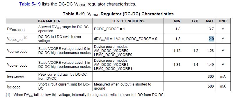

1) When 1.8V battery power supply is used for MSP432P401 with on-chip DC/DC regulator, is there any special considerations we should pay attention to?

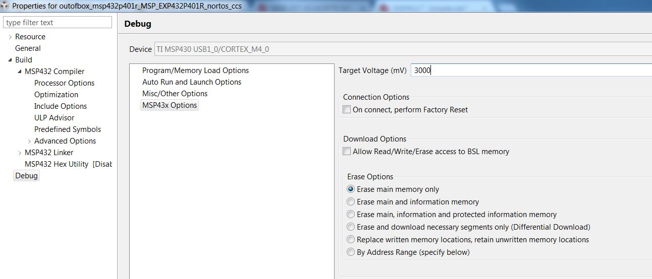

2) If JTAG debugger MSP-FET + adapter MSP-FET-432ADPTR is used, should we add level shifters between 3.3V and 1.8V?
In P15 of http://www.ti.com/lit/ug/slau647i/slau647i.pdf, it says "Software configurable supply voltage between 1.8 V and 3.6 V at 100 mA".
What does that mean by software configurable? Does it mean CCS?

4) In P55 of MSP432P401R datasheet (slas826f.pdf), table 5-19 says "Peak current drawn by DC-DC from DVCC is MAX 300 mA".
Does that mean an external 1.8V LDO or DC/DC output should supply up to 300mA if MSP432P401 on-chip DC/DC is used?

    (2) Level shifters are not required and the control is provided through the IDE.  See attached example for CCS.

    (4) I do not believe that was the intent of that specification.  It is a peak-current while tables like 5.11 show typical active current in the 1-5mA range depending upon the speed.

  • Wayne,
       The DC-DC will not work below 2.0V.  Please refer to and Table 5-19 in the datasheet.
    Chris
