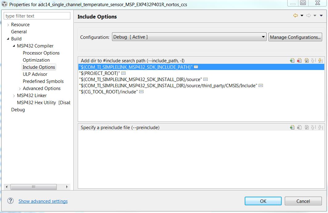

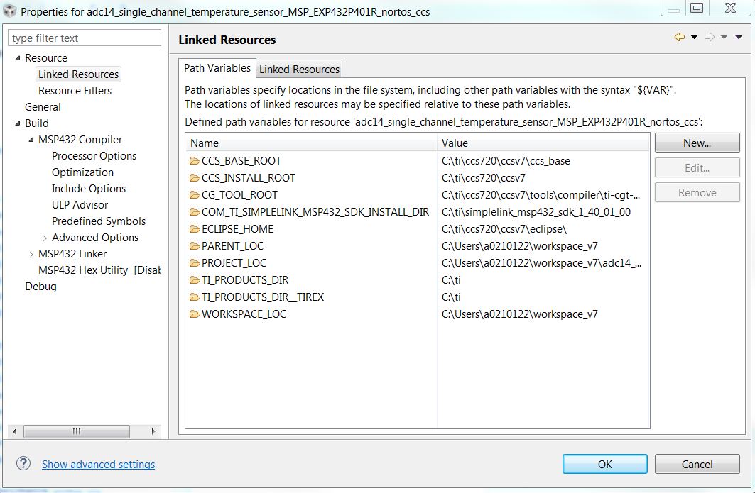

    Tobias,
                   In the CCS project properties there is a products tab (Properties->General).  You should see the available simplelink SDKs there.  Select the SDK you wish to use.
    Your include options should be relative paths based upon the SDK.
    Which is defined automatically in the Path Variables when you select the SDK.
    Let me know if you have any questions or if you are not seeing these windows/parameters.
    Chris
  • Cool, that's working. Thanks for the hint!
