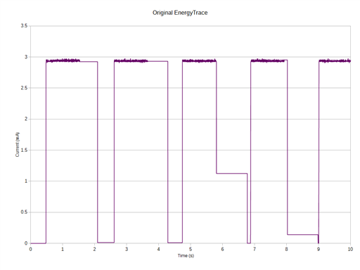

The traces below show a capture of an MSP430G2 firmware which blinks an LED at 0.5Hz in LPM3. The hardware and firmware have been configured to give the lowest possible power consumption while the LED is off. Doing that makes the error much more noticeable.
Here's the trace as reported by the original EnergyTrace processing code:
This chart should show a square wave at 0.5Hz, but the current measurement gets "stuck" at a higher level when it should have dropped to near zero.
What's happening is that the filter algorithm waits to collect sufficient pulses from the DC-DC converter before averaging them. As it does so it keeps outputting records using the last current value that it calculated. When it eventually calculates a new current value, the timestamps it should apply to have already been reported with the previous current value.
This would be unnoticeable if the averaging were performed over a fixed length of time, but instead it is performed over a set number of DC-DC converter pulses. At very low power levels the averaging period can cover as much as 1 second. That's why the trailing edges of these pulses have been extended to such a degree.
Also notice that the initial current is reported as zero until enough input data has been processed to calculate a real value. This is why CCS often shows a minimum power/current of zero when a measurement starts off at low power.
