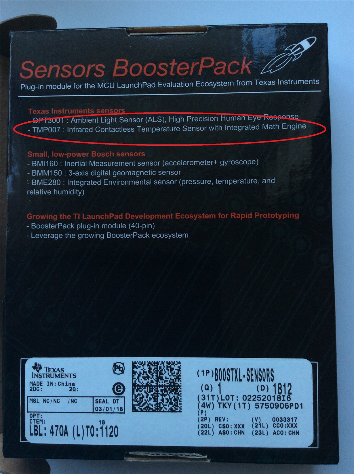

  • The real TMP007 sensor is described on the Booster box.
    Do not dream about him.
    The real TMP007 sensor is described in the paper manual.
    I felt cheated after opening the box.
    Why do adafruit and aliexpres still have TMP007?
