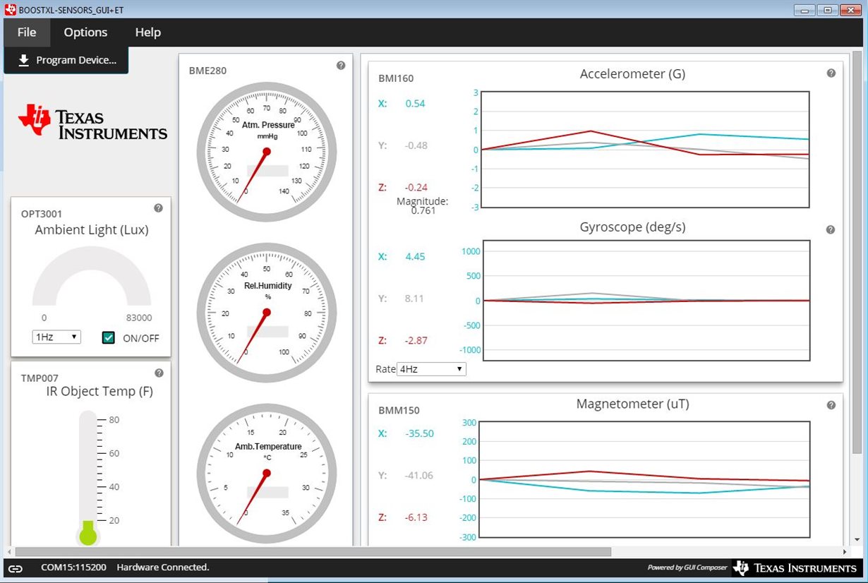

I am working with the red 432P launchpad and BOOSTXL-SENSORS I just received and seeing odds things. Using the latest ET-GUI from:
http://software-dl.ti.com/msp430/msp430_public_sw/mcu/msp430/BOOSTXL-SENSORS/latest/index_FDS.html
Launching the GUI, and programming it as per the users guide. Changed the baud on the GUI and Windows to 115200, used the GUI to successfully program the MCU, everything loaded fine. But the GUI always says “waiting for data”. There is nothing in the guide about needing button inputs but I started pressing them and it takes pressing S3 (which is reset?) for it to connect. Doing that allows it to connect. Still no sensor data is streaming. You have to press S3 again and you get a single momentary ping of sensor data for the accelerometer (no other sensors ever register). I have closed the GUI and unpluged/re plugged the launchpad and it’s the same. I have done nothing out of the ordinary, so I’m at a loss.
What do you suppose is going on?

  • Hello Billy,
    I imported the application from the latest SDK in CCSv8, built and downloaded the firmware. After that I used the GUI to connect to read the data and it worked as expected and it has been running for the last 3 minutes without any issues. I can see the data change for the Ambient Light and Board Movement getting recorded.
    When i try to download the firmware using the GUI it fails to program though.
  • Hi Amit,
    The GUI programs it fine, I did so twice hoping it was just a bad load. You may have had a baud issue or port issue or something else. I did not know this exact same project existed in the SDK. I would have gone that route from the jump. I went this route with the BOOSTXL-SENSORS package for simplicity and because thats what a customer I was helping was following.
    So in the end if the SDK project works but the binary packaged in the GUI-ET here doesn’t, can you/someone replace the binary? I see the GUI is pulling that locally in the package from:

    Well you don't need to worry about comparing the binary's anymore, its not that.  I am beginning to think I have a bad sensor boosterpack. Its the exact same situation using the CCS project out of the SDK on this machine, Win 7/32 bit. Everything loads and programs just fine, drivers are fine, com ports fine, it connects but still no live data. I have to keep hitting the reset button and only get a 1 time ping of data each time I press it. And that’s just data from the 3 sensors on the right, see my screenshot. I've yet to see any other sensors become active.
    I then took it to my personal Win 10/64 bit, grabbed the GUI package, launched it and its identical. I have to keep pressing reset and just get a 1 time ping and only on those 3 sensors:
    What do you think? Bad boosterpack?

  • Hello Billy,
    After debug we did determine that the TMP007 is not populated on the new boards as it has been OBSOLETE. The suggested workaround is to comment the code that initializes the TMP007 and reads data from it. We will file a software change request so that it can be made customizable based on the new board. Also attached is the code for the same, in case other forum users run into the same issue.
    I will close the forum post in case there are no further issues.
