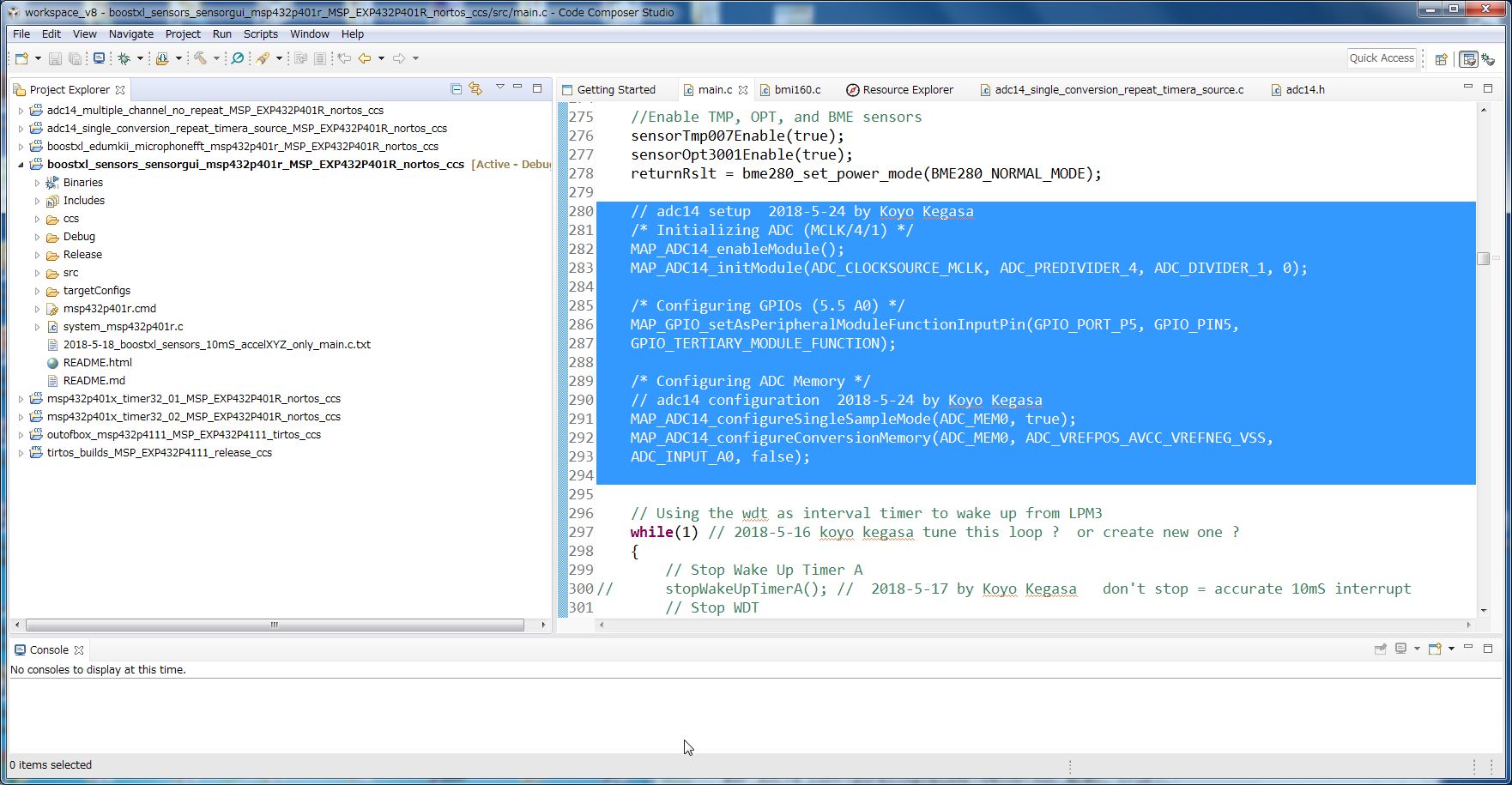

As I want to measure voltage with the accelerations, I add 14 bit ADC program as below
(1) initialize ADC14
(2) start ADC14 conversion and get data and send it as text.
I can get the voltage with acceleration all right.

There is one problem.

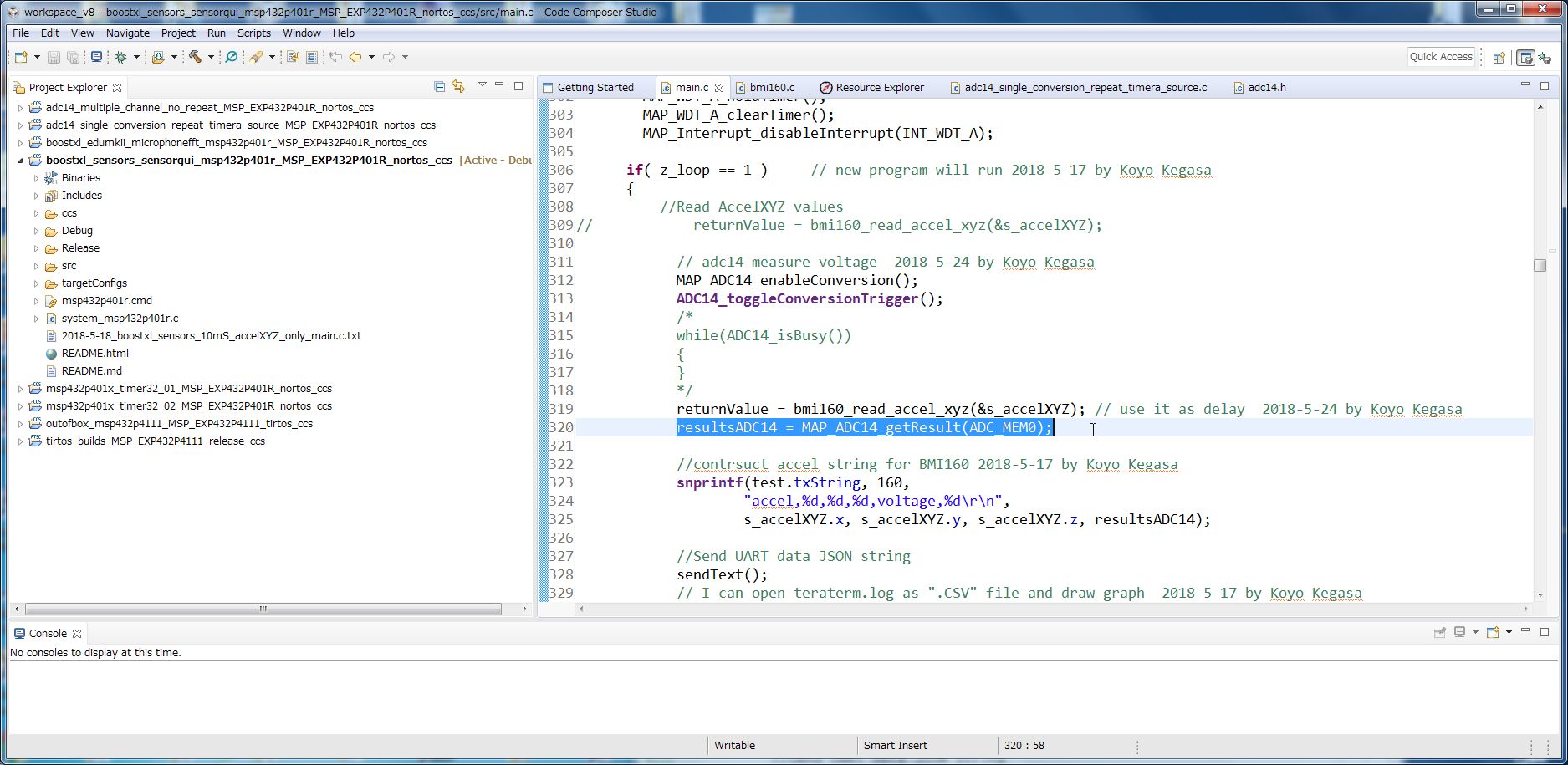

When I tried to wait for the completion of the ADC14 as below -
            while(ADC14_isBusy())
The program is stopped here forever.
So, I comment it out.
Are there any better way to wait for completion of the ADC14 conversion ?
Just wait for several micro-second and read the result is OK ?
Hope to receive some answer soon !

  • Koyo,
      I don't see that issue when I add the wait loop. The program continues running as normal.
    while(ADC14_isBusy()){
    resultsADC14= MAP_ADC14_getResult(ADC_MEM0);
    Another way to wait for the results would be to use an interrupt. An example of this can be found in the TI Resource Explorer under the SimpleLink MSP432 SDK.  Look for the adc14_single_conversion_repeat example.
      Bob L.
    PS- You don't need to do ADC14_enableConversion inside your loop- this should be done outside of the main loop along with other configuration code. (this doesn't seem to affect my code though)
