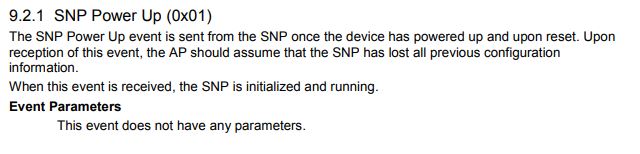

I have successfully tested the code both RX and TX using the terminal editor. The issue is when I connect to CC2560. I am using the NPI protocol
Question: When communication with CC2650, the UART is inconsistent in reading the data. The data gets lost sometime. Sometimes the data is read accurately. The expect response form the CC2650 is for SNP Power Up
I am wondering if UART is properly configured. I used the information as described at Unified Network Processor Interface to configure the UART port.
