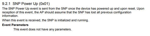

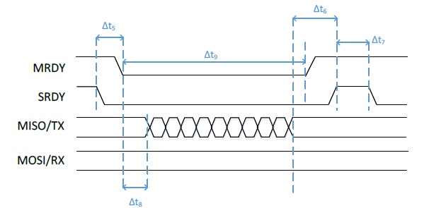

I am working on integrating MSP430F5529 to BOOSTXL-CC2650MA, using NPI protocol. I am using the UART option. I am unable to consistently receive data from the CC2650. Can some one point to where I can access the signal timing values (ts, t9, t8, t7, t6)as described by image below.
I have confirm function of the UART  via Tera Term.  I also have confirmed that both MRDY and SRDY pulled low to enable communication. If needed I can provide scoop traces. MSP430F5529 is host, and I am using stock software on BOOSTXL-CC2650MA.

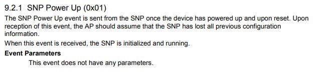

I am trying to receive the following response from the CC2650.

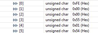

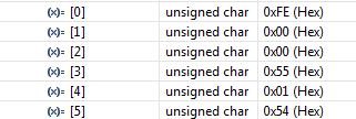

When I step through the code I receive the following (correct response) data from the UART Port.

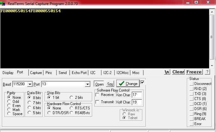

Here is a snap shot of data from UART port using Realterm
