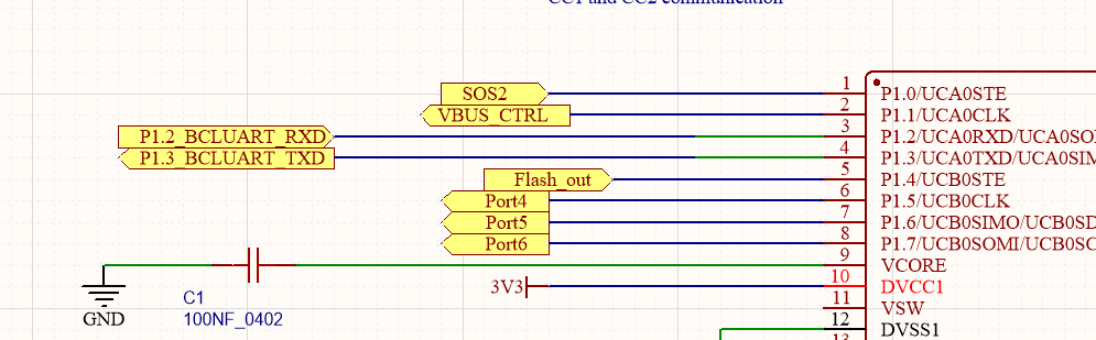

I am facing an error with Error code -261 and i have exactly understood why i am getting this error, as i got succeeded to replicate this error in launchpad.
I am facing this error because i have used LDO operating mode in the circuit of custom board having MSP432P401RIRGCT as target device, leaving the VSW pin unconnected as recommended in datasheet and shown in attached image.
I am unable to understand what are correct sysconfig to get the DUT work in LDO operating Mode.
On removing L1 and C10, i was succesful in reproducing the same error in launchpad, the LDO config i used is suggested in the below thread by James Evans, but the error persists.
https://e2e.ti.com/support/microcontrollers/msp430/f/166/p/918268/3393792#3393792
Please suggest me how to resolve this error.

  • Yes checked.
    I am sure it is not the power or other signal issue.
    I have reproduced the same error in Launchpad by just removing L1 and C10
    When i resoldered back both the components again, everything started working fine in launchpad.
    So the error is caused by these two components as i am operating my custom board in LDO mode, where both of these components are not populated.
    You can also reproduce the same issue in launchpad by removing L1 and C10 as recommended for LDO operation in datasheet. (VSW Pin is left unconnected and 100nf capacitor is enough for vcore for LDO mode as stated in datasheet)
    If you try using DC DC software configuration with LDO hardware connections, the also the same error will occur.
    So the issue is that i am unable to find correct LDO software configuration.
    Is there any document/guide to assist me how to use msp432 in LDO operating mode?
