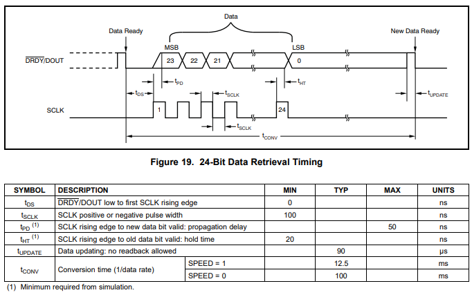

  • Based on data sheet (SBAS414D) Fig 19, I think you need UCCKPL=0. (UCCKPH=0 looks right.)
    The section "Data Retrieval" (immediately preceding) says that DRDY/DOUT is indeterminate between reading the 3 bytes and the next DRDY event. This may mean your code is reading when there's no sample ready. The fix/workaround they suggest is to do a 25th SCK cycle; doing a single cycle isn't so easy to do, but I suspect sending another byte (8 more SCK cycles) then throwing away the result will accomplish the same purpose.
    SPI speed of 9.6kHz is pretty slow. Are you fairly certain you'll fetch everything within Tupdate? The table on p.3 indicates it can run up to 5MHz.

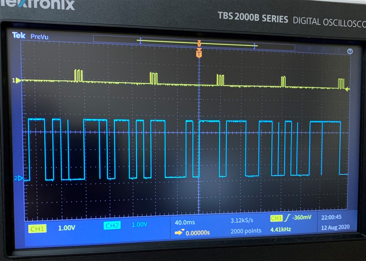

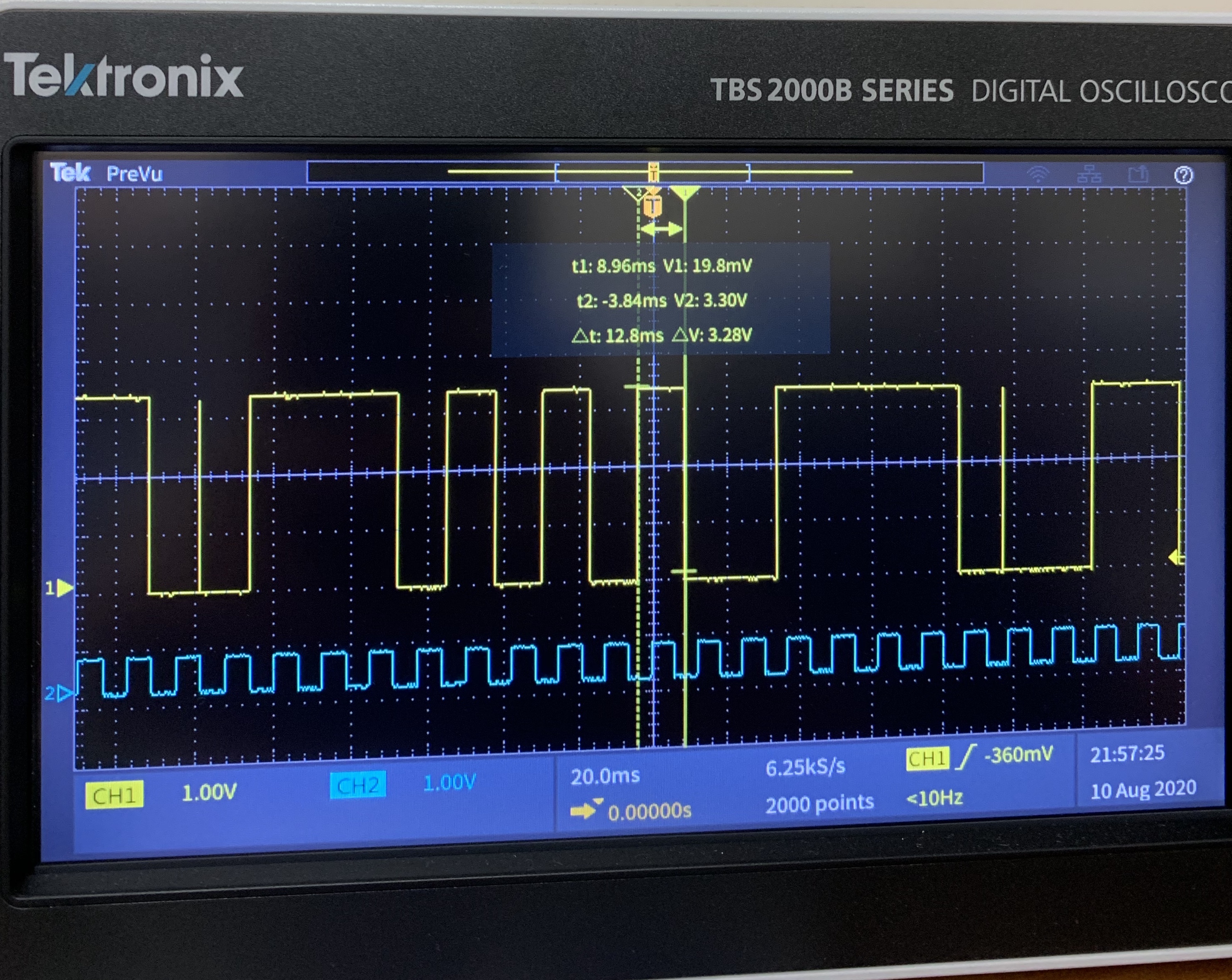

  • The SCLK signal has been very variable for me. I've attached two pictures to further detail my issue.
    The first picture shows the SCLK signal on my oscilloscope, with a probe attached to both the ADS1231REF side of the wire and the MSP430 side. The second picture is a zoomed-in view. As you can see, the SCLK signal is not functioning as intended. What can I do to output the correct clock signal from my MSP430 launchpad?
  • It looks as though your scope is sampling at about 6ksps, which is much too slow to catch a 1MHz SCLK signal. Can you convince it to sample faster?

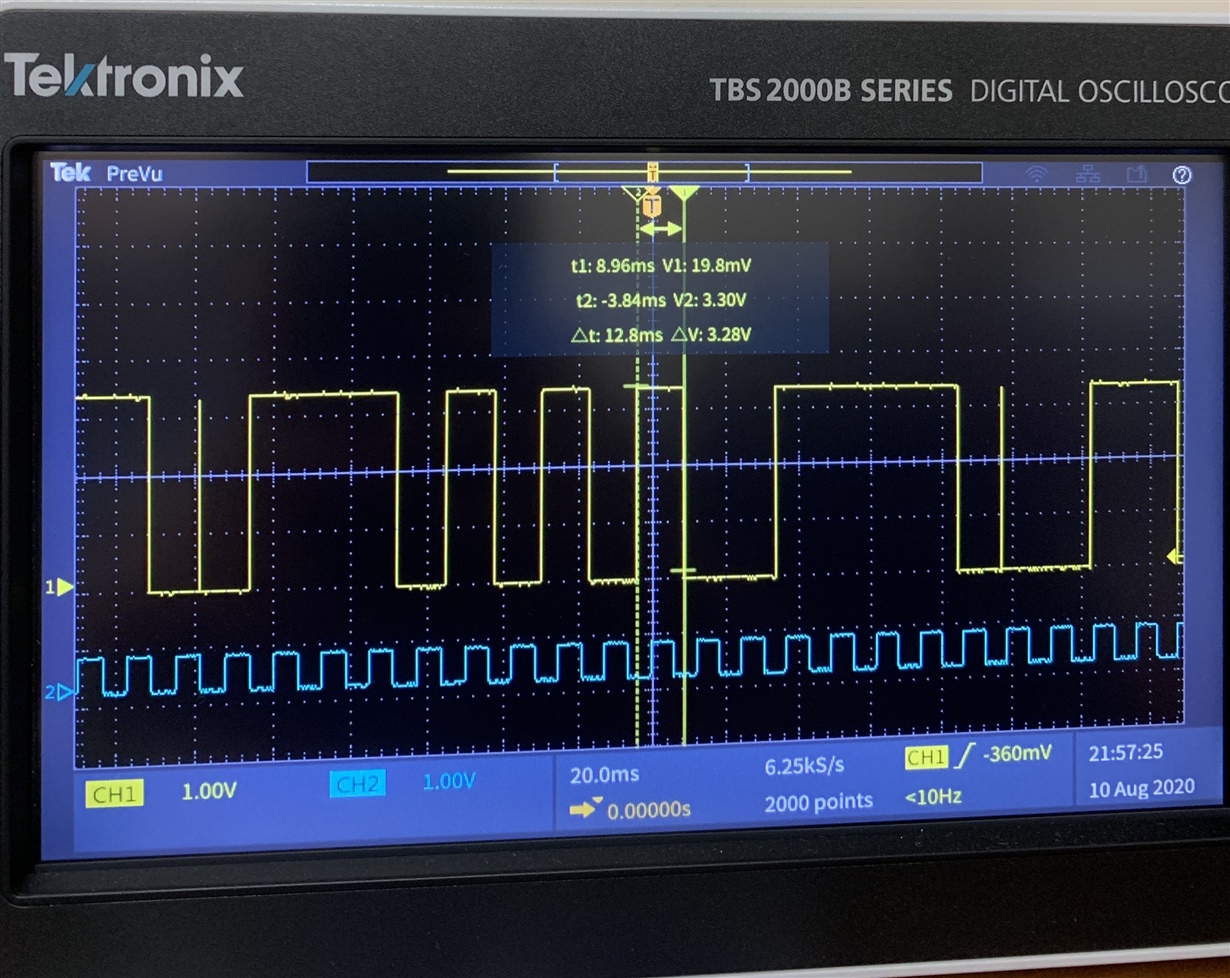

  • I modified my code so that SCLK runs at approximately 80 Hz in order to synchronize with the data rate of the ADS1231REF, which is 80 sps when high. To divide the 32,768 Hz ACLK signal sourced from MSP430 into an 80 Hz signal, I set UCB0BRW to 410. However, the precise prescaler to achieve 80 Hz from 32.768 kHz is 409.6. How can I achieve this 0.6? Thanks!
  • Each sample is 24 bits, so your SCLK absolute minimum at 80sps would be 24*80=1920Hz. It should actually be quite a bit faster, since you won't be able to keep the SPI busy all the time.
    To answer your question: All the USCI gives you is an integer divider, so that limits you in what bit-clock rates you can actually generate. SPI is generally not very sensitive to bit-clock speed.
  • I thought it should be 1920 Hz as well, but it seems from my oscilloscope that each bit of data is roughly 12.5 ms long, meaning only 80 bits are transferred every second.
  • Each SCLK is 1 bit, so SCLK=80Hz gives you 80 bits/second, or just over 3 samples/second. SCLK=1920Hz gives you (80*24) bits/second, or about 80 samples/second.
    More generally, I'm not clear what your goal is in running the SCLK so slowly. As the SPI master, you have total control over the bus speed, so there is rarely a reason to run the SPI much slower than the slave is capable of. SCLK=1MHz should be fine. Google tells me that your scope is capable of capturing 70MHz, so with the right settings you should be able to see even a fast SCLK.

  • When I set SCLK faster (in this case to 32.768 kHz), the clock doesn't run continuously like it did at 80 Hz, but instead it pulses every so often, as you can see in the image below. How can the bits shift out if the clock only pulses during the duration of one, maybe two bits?
  • The bursty behavior of SCLK is expected. In between, your program is spinning on P7IN, waiting for DRDY. This is a good thing. As your program develops, you'll find other things to do in between DRDY signals.

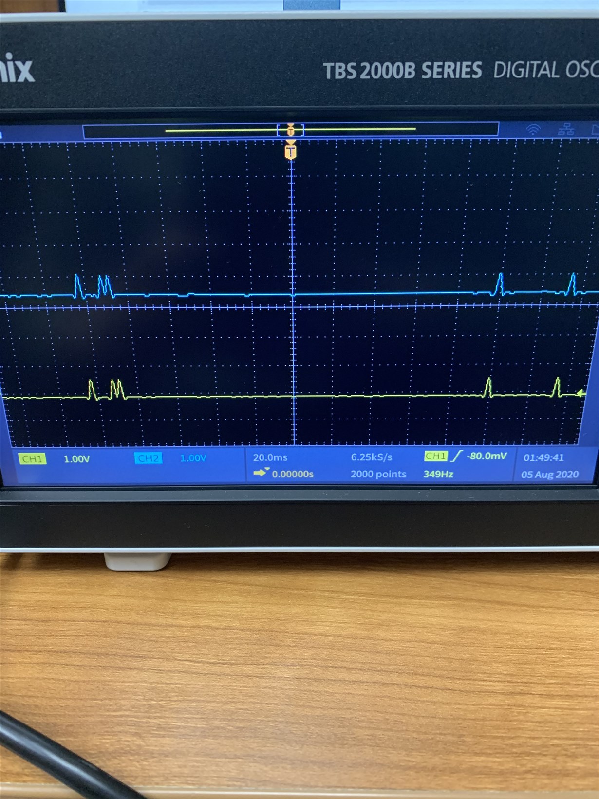

    I only see a few SCLK cycles in each burst on your scope, but I'm not sure I believe that since I also see "3.12kS/s" down at the bottom, which is much too slow to see a 32kHz SCLK. Google tells me that your scope can capture 70MHz, with the appropriate settings. (Is there a knob marked "T"ime or "X" or "Horizontal"?)
    What sort of (numeric) results are you seeing? And what results are you expecting, based on what you're providing to the ADC's input?
  • There are two knobs in the "Horizontal" section. One to adjust the position and the other for the scale. I can turn the "scale" knob to increase the sampling rate.
    I've noticed that when I stop my program, there are more clock pulses than when the program is running. The expected results should be a digital code around 239880 in decimal. However, these are the results I'm receiving with a 32,768 Hz SCLK:

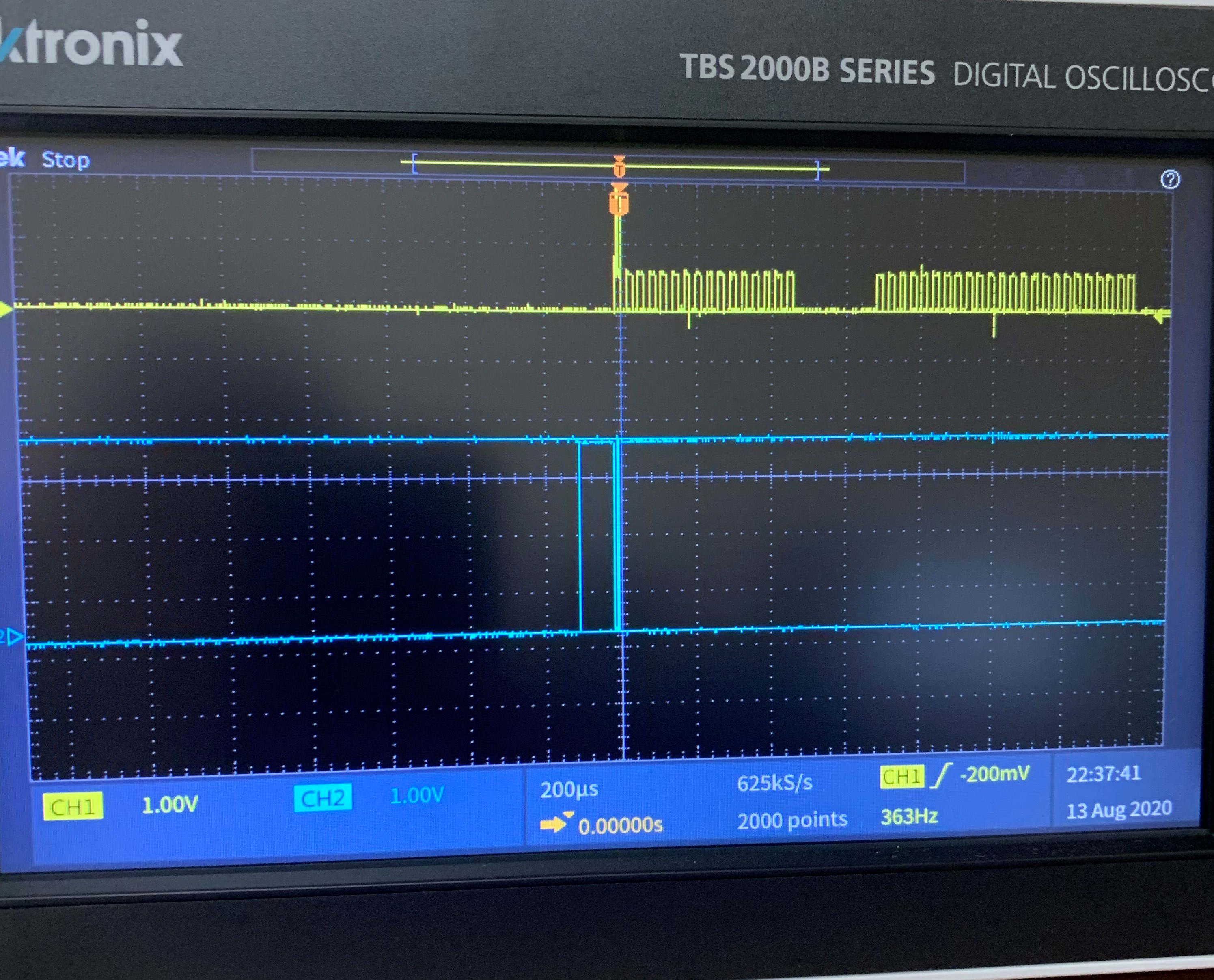

  • 1) Data sheet p. 13 says to "Avoid data retrieval during the update period (Tupdate)", without saying what the consequences are. You wait for DRDY (P7.0) to go high, then start the transaction. This actually starts the transfer within Tupdate. After the "while (!(P2IN&BIT0))" add another loop "while (P2IN & BIT0)" to wait for DRDY to go low (about 90 usec).
    2) With the Horizontal axis expanded, do you see DRDY go low after sending the extra "dummy" byte? What we're doing isn't strictly according to the data sheet; I still expect it does the right thing, but it would be good to see it.
    My spreadsheet says that code 239880 corresponds to about 559 uV (micro-volts). Does that sound about right? [Ref REF data sheet (SBAU175A) Formula (3), ADS1231 data sheet (SBAS414D) Table 3]
  • I thought by transmitting a fourth value to UCB0TXBUF and generating a 25th clock pulse, DRDY is set high and, and then the program ("while(!(P7IN & BIT0))") polls P7.0 until it goes low and new data is ready to be outputted. If this is the case, what is the purpose of adding a second loop?
    From what I can tell, DRDY is not forced high after sending the extra "dummy" byte. It's hard to tell which clock pulse aligns with which of the four bytes being transmitted, but there is no point in the oscilloscope reading where DRDY remains high. As you can see, the clock is not generated for long enough at one time, and the same bit might be picked up at two subsequent rising edges. This is why I figured I should set SCLK to 80 Hz, so at each rising edge there is a new bit ready to be transmitted.

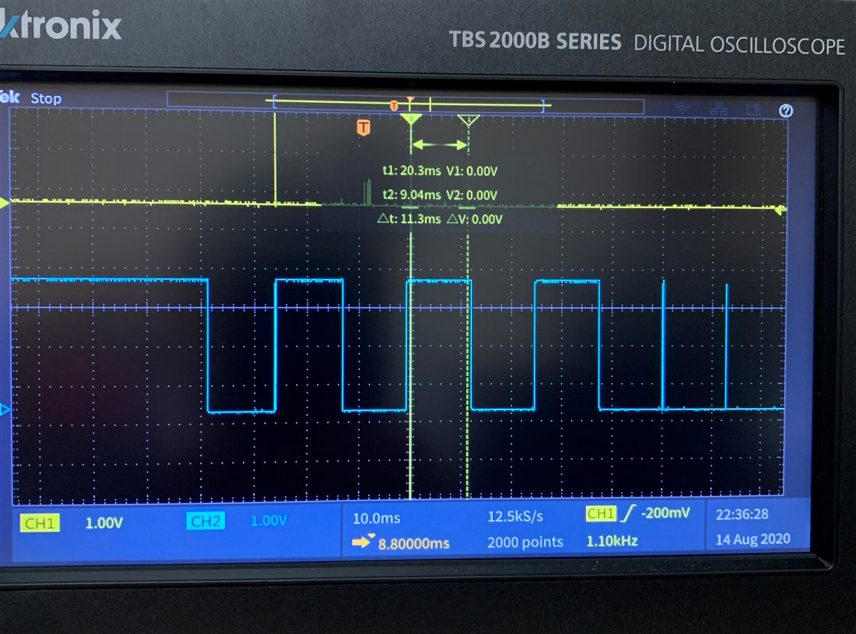

    I can get more horizontal resolution from my scope, but the signal becomes very choppy and it's difficult to pause the run at the right place, but I managed to get a picture. As you can see, SCLK goes by so quickly that it picks up data from only one bit.
  • 1) Your original loop was constructed to keep looping "while" P7.0 was low (=0) and break out when P7.0 went high (=1). The effect is to wait for P7.0 to go high. I suggested reversing the logic so it breaks out of the while loop when P7.0 goes low.
    2) The scope trace is a little hard to read, CH2 seems to have multiple traces, maybe some kind of persistence. (On my Rigol scope I get rid of this by stepping the Horizontal knob one step either direction, then back where it was. I guess it forces the scope to re-draw the screen or something.) But it looks (sort of) like you're running SCLK while DRDY is high, which would match with the code (see (1)).
    What concerns me more is that the SCLK (CH1) amplitude is only around 0.5V. I suppose this could be a scope (aliasing) artifact, but those aren't usually so consistent.
    Looking at the ADS1231REF schematics, I don't see a way to switch off the MSP430F449 chip, nor to disconnect SCLK/DOUT from it. It's possible that the on-board MSP430 is fighting with you (bus contention) for SCLK. Did you modify the REF board? Or is there some switch or something that I'm not seeing?
    [Edit: Here's a quick experiment: Press and hold down the RST button (SW6) on the REF board while you run your program, and see if the CH1 trace changes (maybe up to 3V). Holding the F449 in reset will force it to let go of SCLK.]

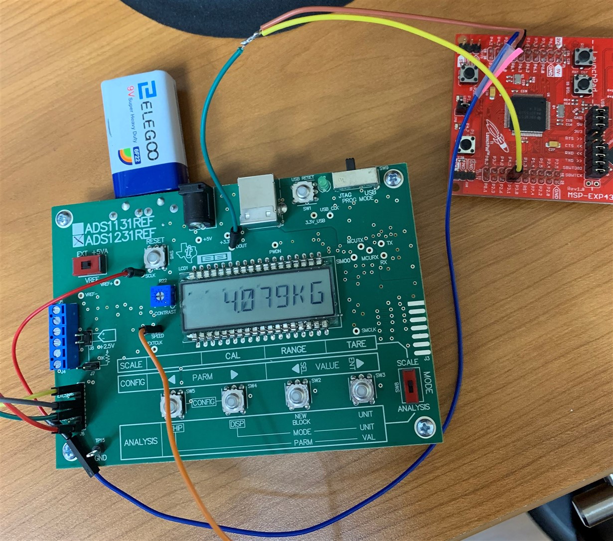

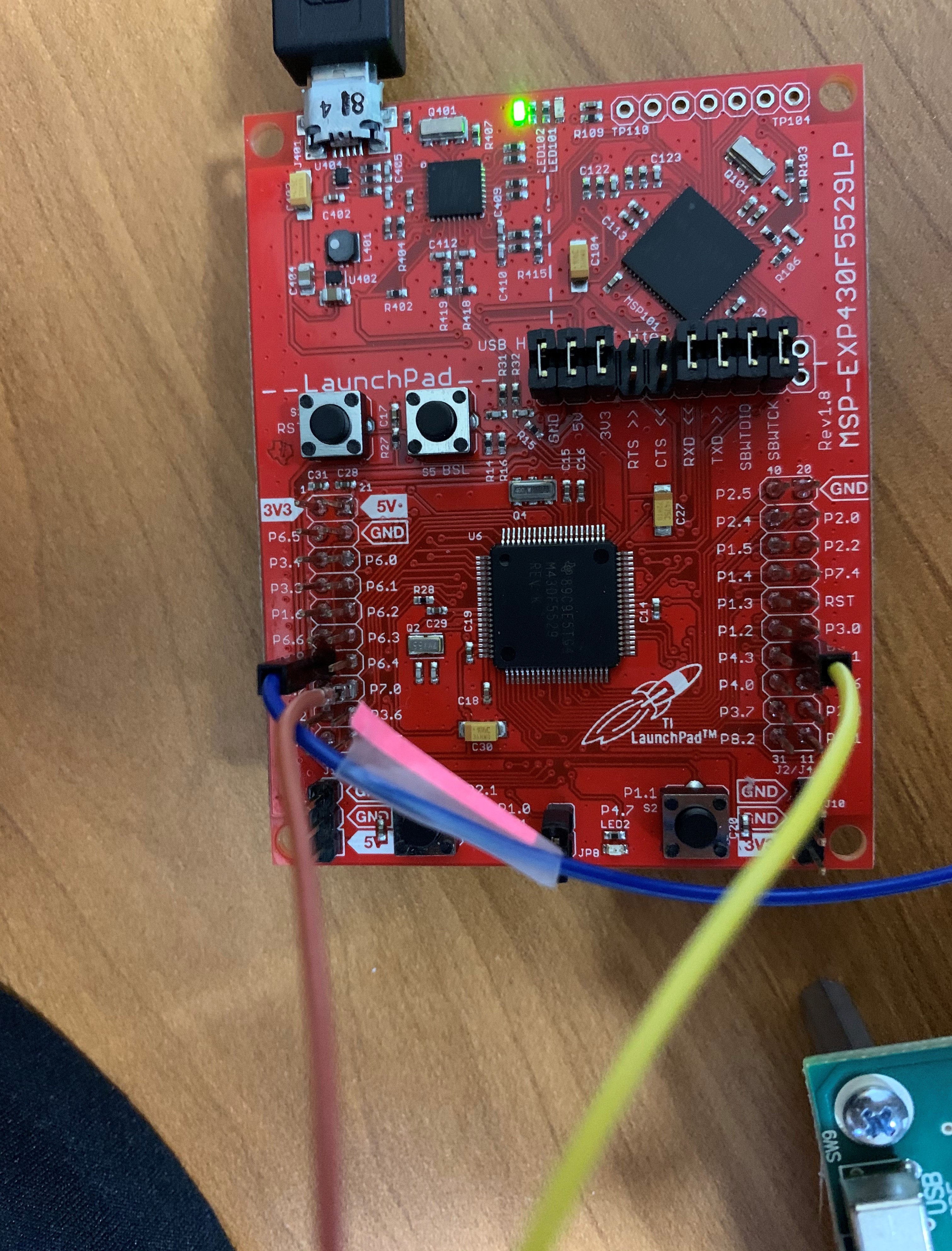

    Here's a few photos of my setup. The ADS1231REF board is connected at the load cell header to a wooden slab on which four 50 kg load cells are attached to each corner.
    The button I held down to reset the ADS1231REF board was SW6.
  • Looking at the LCD screen, it really looks like the on-board MCU is running, and probably driving SCLK low to create a bus-conflict with your SCLK.
