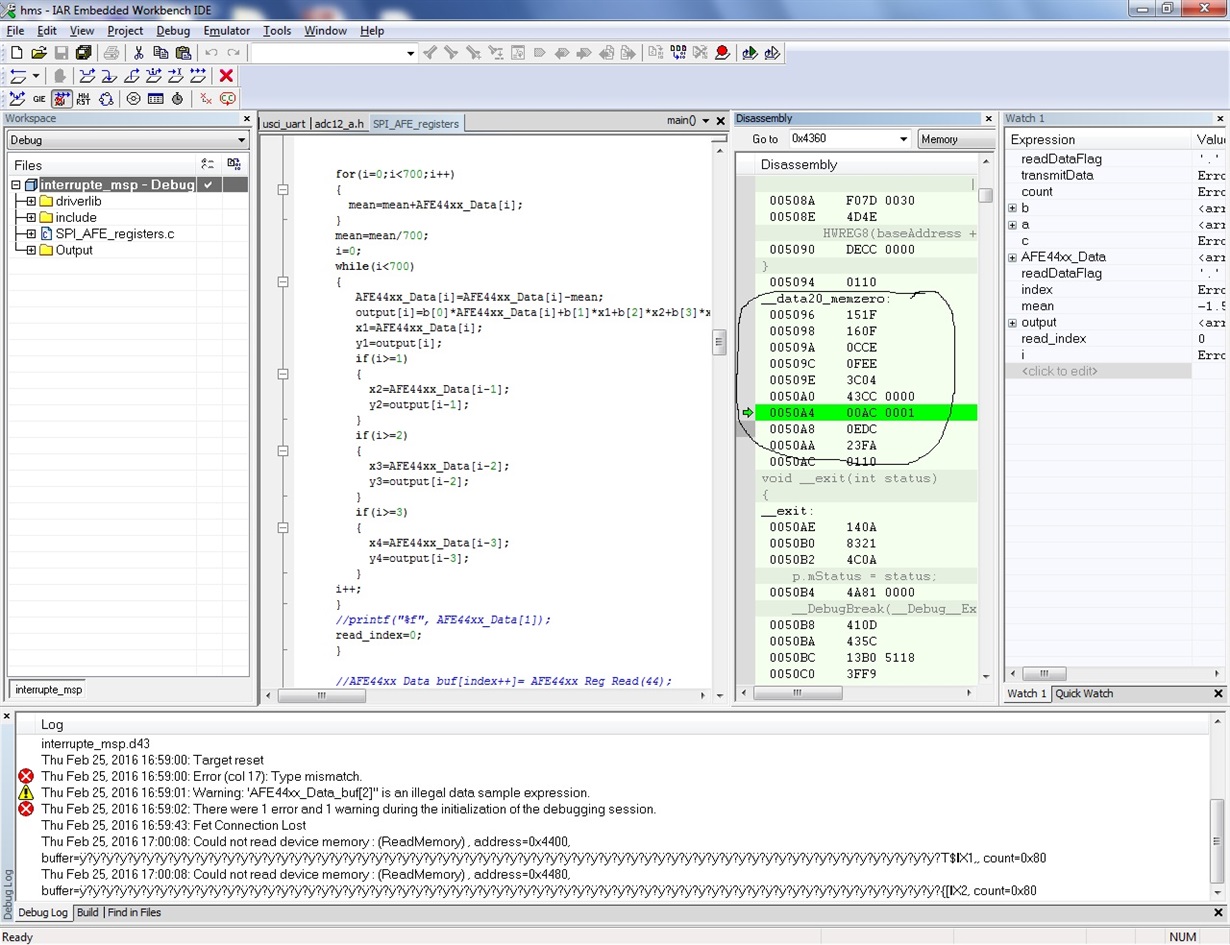

MSP430 program automatically running after dumping without me pressing the run button
Other Parts Discussed in Thread: MSP430F5528
Hello
I tried to dump the program in MSP430F5528. The program gets compiled and linked successfully but after dumping it is not running into main. It is stuck into infinite loop in data memory when I put break. I am sending the C code. Please check and help me resolve the issue.

  • Does it behave the same way when you uncomment low level init function which disables watchdog timer early?
    /*int low_level_init(void){
    WDTCTL=WDTPW+WDTHOLD;
    return 1;
  • Hi
    Ya with those lines uncommented also the program is behaving the same way.Can you please check it on your side and rectify the issue?
    Arnab
  • >Can you please check it on your side and rectify the issue?
    No. Why should I?
    One more thing you shall check: debugger options. "Run into main()" shall be enabled. Also check that CPU type is set properly, check stack size and it's usage. Also check where exactly debugger program is stuck in the infinite loop, what part of your or library/startup code it is, try to think of reasons why it is stuck there.
  • Hi
    I have checked that my program is everytime stuck at __data20_memzero: section but couldn't figure out whats the reason. I checked the stack also but there is no overflow there. I checked the debugger options also and there Run to main() is enabled.I am sending the screenshot. Please let me know if you can figure out the same.
    Arnab
  • Your debugger screen shows "Fet Connection Lost". It means that for some reason your chip/program is reset, most probably stuck in continuous reset/crash loop - that's why you think it is looping in the init part of the code. Typical reason is Watchdog kicking in before C init is done due to huge size of variable memory. In your case I see two double arrays of 700 elements. This is huge for msp430 at default 1MHz.
    Your problem most probably is improper name of low level init function. It shall look like this:
    int __low_level_init(void) {
    WDTCTL = WDTPW + WDTHOLD;
    return 1;
  • Hi
    Actually I had taken the screenshot in my PC after disconnecting the debugger from my board. Thats why you see the message FET connection lost. I will change the low_level_init syntax and see if it works.
    Arnab
  • Hi
    The problem got resolved. Thanks for your prompt response.
    Arnab
