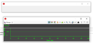

Energytrace windows are gone crazy.
I clicked X and I close EnergyTrace++ window. Only Power, states, Energy sub-windows stayed  visible. I de attach the power window and now I can't detach it
Also, the main  Energytrace++ or EnergyTrace window is empty.
The detach option just change the height of the window.
I want your advice on how to restore the functionality of window.
Also I want to be able to run Energytrace++ at Run mode not only at debug mode.

    What version of CCS are you using? I'm using CCS v10.1 and when I close the EnergyTrace window, everything goes away including the Power and Energy tabs.
    If you detach a tab, you can always click, hold and drag the detached tab back to the EnergyTrace window. It will re-attach. If that doesn't work for you for some reason, you could always create another project. That should reset the view back to default.

    When I close the main window which corresponds to EnergeTrace all sub-windows go away. The problem is that the main window is empty. No solution found in E2e.ti.com solved the problem.

    What happens when you try to re-open EnergyTrace in CCS during an active debug session? In CCS, click Tools > EnergyTrace. For me, after I close the EnergyTrace window, I am able to re-open in consistently in CCS.
  • SOLUTION
    I delete all .xxxx files found in the workspace directory.
    I don't know which file is responsible but now EnergyTrace restored to default.
