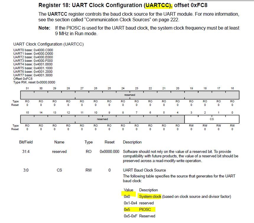

EK-TM4C123GXL: How to set up clock Frequency for UART communication in UART_CC_R?
Part Number: EK-TM4C123GXL
I need to set up  clock frequency of 33.3MHz and set a Baud Rate of 9600 using UART0.
My SYSCLK is on 40 Mhz.
As UART_CC_R has only 4 bits to RW I'm not sure how can a value be assigned in UART_CC_R?
Thanks in advance.

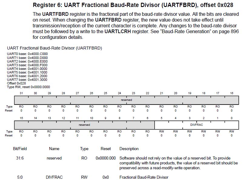

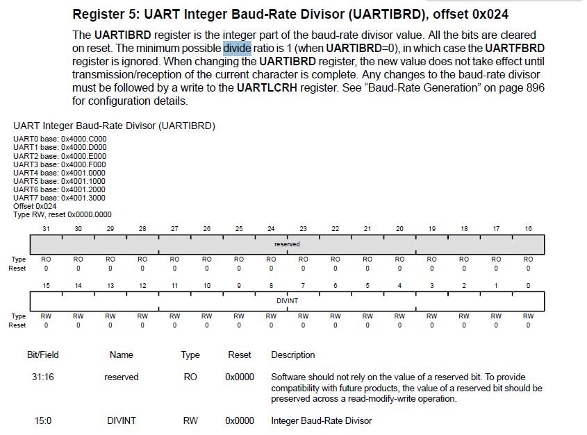

      The UART_CC is a register to select the clock source for the UART module. It is not a divisor. Below is the excerpt from the datasheet.
    By default it is selecting the SYSCLK as the clock source. You said you have already configured your system clock to be 40MHz. What you need to is divide the SYSCLK to proper baud rate using UARTIBRD and UARTFBRT registers.
    Please note we do not support DRM (direct register manipulation) style of coding. If you need to use DRM then please look at how the API implements the code to configure the UART baud rate. The API to use will be  UARTConfigSetExpClk. Below is an example to configure the UART with 115200 baud rate.
