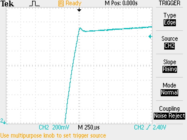

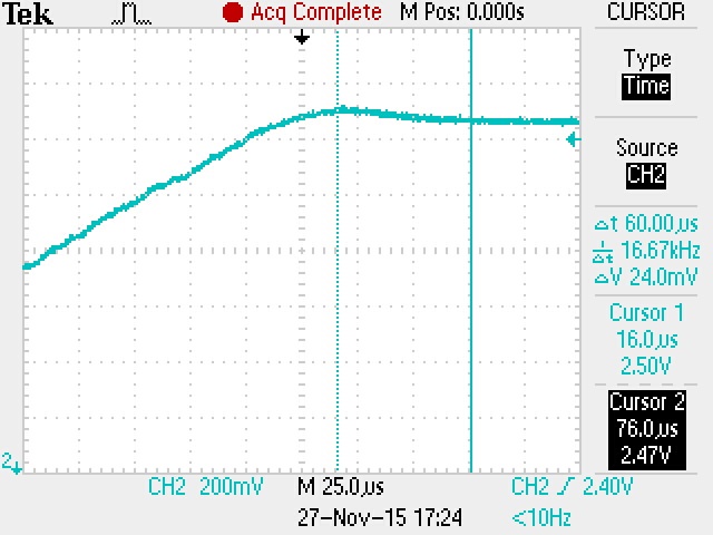

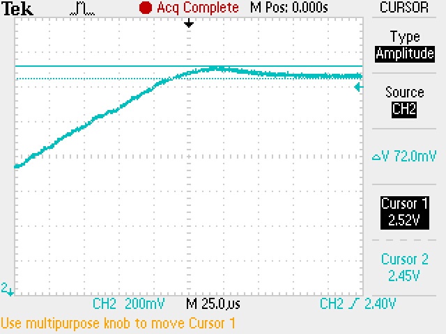

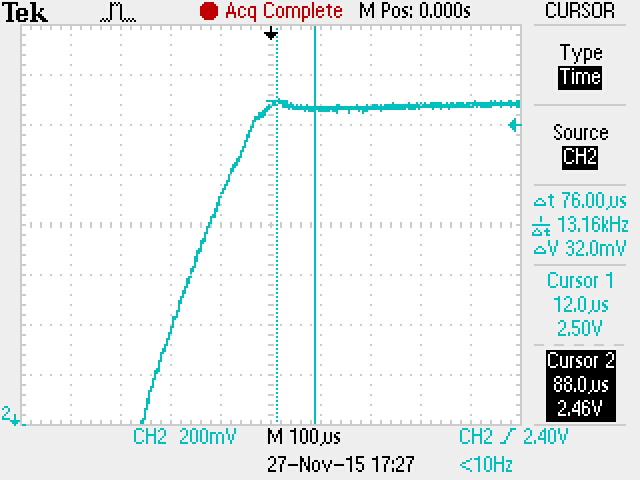

We've been checking our power supply to see if we may be running afoul of the SYSCTL #16 errata. The wording on the errata is somewhat opaque and we are not sure we understand it.
The bottom image is a scope capture and shows a overshoot, presumably as the LDO switches on). The second image from the bottom shows a zoom-in of that section illustrating a peak of around 75mV, compared to 75 to 100uS later.
I think I would interpret this as being a risk for SYSCTL #16 but It's not entirely clear.  I also would have expected there might be some bounds on the magnitude of the difference but that's not mentioned in the errata either.
