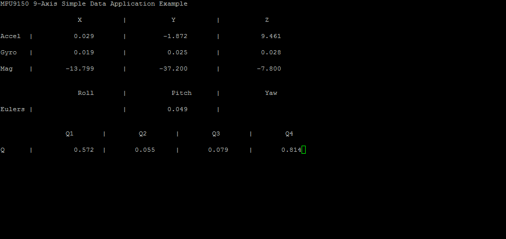

Hey Forum,
My issue is with using the UART output to the putty terminal. I was attempting to mimic the output of the demo sensorHub code displayed below....
 I was trying to use the same format to display data from my own project (DIY Segway) but i was running into some issues. I have configured my UART the same but my output is not as near to the example. My output is shown below......
 The value options repeat and then i believe my uart is overflowed with information. So what im am trying to achieve is a way to demonstrate my data without the UART constantly repeating the variable names and only updating the variable number.
I have my code attached below and i have posted the sensor hub demo code as well.
MY CODE:
void initUart()
	SysCtlPeripheralEnable(SYSCTL_PERIPH_GPIOA);
	SysCtlPeripheralEnable(SYSCTL_PERIPH_UART0);
	GPIOPinConfigure(GPIO_PA0_U0RX);
	GPIOPinConfigure(GPIO_PA1_U0TX);
	GPIOPinTypeUART(GPIO_PORTA_BASE, GPIO_PIN_0 | GPIO_PIN_1);
	UARTClockSourceSet(UART0_BASE, UART_CLOCK_PIOSC);
	UARTStdioConfig(0, 115200, 16000000);
void outputData(int LeftPWM, int RightPWM, int turningVal, int timeVal, int finalMotorVal,int pitchVal, int pitchDeci)
    UARTprintf("\033[2J\033[H");
    UARTprintf("Segway Interface Value Monitor\n\n");
    UARTprintf("Pitch Angle\033[31G|\n\n");//accel
    UARTprintf("Left PWM\033[31G Right PWM\n\n");//[54G|
    UARTprintf("Turning Value\033[31G|\n\n");
    UARTprintf("Final Motor Value\033[31G|\n\n");
    UARTprintf("Time Value\033[31G|\n\n");
	g_ui32PrintSkipCounter++;
	if(g_ui32PrintSkipCounter >= PRINT_SKIP_COUNT)
		// Reset skip counter.
		g_ui32PrintSkipCounter = 0;
        UARTprintf("\033[5;17H%3d.%03d", pitchVal, pitchDeci);
        UARTprintf("\033[7;17H%3d %3d", LeftPWM, RightPWM);
        UARTprintf("\033[9;17H%3d", turningVal);
        UARTprintf("\033[19;14H%3d", finalMotorVal);
        UARTprintf("\033[19;17H%3d", timeVal);

    // MPU9150
    ROM_GPIOPinTypeGPIOInput(GPIO_PORTB_BASE, GPIO_PIN_2);
    GPIOIntEnable(GPIO_PORTB_BASE, GPIO_PIN_2);
    ROM_GPIOIntTypeSet(GPIO_PORTB_BASE, GPIO_PIN_2, GPIO_FALLING_EDGE);
    ROM_IntEnable(INT_GPIOB);
    // Keep only some parts of the systems running while in sleep mode.
    // GPIOB is for the MPU9150 interrupt pin.
    // UART0 is the virtual serial port
    // TIMER0, TIMER1 and WTIMER5 are used by the RGB driver
    // I2C3 is the I2C interface to the ISL29023
    ROM_SysCtlPeripheralClockGating(true);
    ROM_SysCtlPeripheralSleepEnable(SYSCTL_PERIPH_GPIOB);
    ROM_SysCtlPeripheralSleepEnable(SYSCTL_PERIPH_UART0);
    ROM_SysCtlPeripheralSleepEnable(SYSCTL_PERIPH_TIMER0);
    ROM_SysCtlPeripheralSleepEnable(SYSCTL_PERIPH_TIMER1);
    ROM_SysCtlPeripheralSleepEnable(SYSCTL_PERIPH_I2C3);
    ROM_SysCtlPeripheralSleepEnable(SYSCTL_PERIPH_WTIMER5);
    // Enable interrupts to the processor.
    ROM_IntMasterEnable();
    // Initialize I2C3 peripheral.
    I2CMInit(&g_sI2CInst, I2C3_BASE, INT_I2C3, 0xff, 0xff,
             ROM_SysCtlClockGet());
    // Initialize the MPU9150 Driver.
    MPU9150Init(&g_sMPU9150Inst, &g_sI2CInst, MPU9150_I2C_ADDRESS,
                MPU9150AppCallback, &g_sMPU9150Inst);
    // Wait for transaction to complete
    MPU9150AppI2CWait(__FILE__, __LINE__);
    // Write application specifice sensor configuration such as filter settings
    // and sensor range settings.
    g_sMPU9150Inst.pui8Data[0] = MPU9150_CONFIG_DLPF_CFG_94_98;
    g_sMPU9150Inst.pui8Data[1] = MPU9150_GYRO_CONFIG_FS_SEL_250;
    g_sMPU9150Inst.pui8Data[2] = (MPU9150_ACCEL_CONFIG_ACCEL_HPF_5HZ |
                                  MPU9150_ACCEL_CONFIG_AFS_SEL_2G);
    MPU9150Write(&g_sMPU9150Inst, MPU9150_O_CONFIG, g_sMPU9150Inst.pui8Data, 3,
    // Configure the data ready interrupt pin output of the MPU9150.
    g_sMPU9150Inst.pui8Data[0] = MPU9150_INT_PIN_CFG_INT_LEVEL |
                                    MPU9150_INT_PIN_CFG_INT_RD_CLEAR |
                                    MPU9150_INT_PIN_CFG_LATCH_INT_EN;
    g_sMPU9150Inst.pui8Data[1] = MPU9150_INT_ENABLE_DATA_RDY_EN;
    MPU9150Write(&g_sMPU9150Inst, MPU9150_O_INT_PIN_CFG,
                 g_sMPU9150Inst.pui8Data, 2, MPU9150AppCallback,
                 &g_sMPU9150Inst);
    // Initialize the DCM system. 50 hz sample rate.
    // accel weight = .2, gyro weight = .8, mag weight = .2
    CompDCMInit(&g_sCompDCMInst, 1.0f / 50.0f, 0.2f, 0.6f, 0.2f);
    UARTprintf("MPU9150 9-Axis Simple Data Application Example\n\n");
    UARTprintf("\033[20GX\033[31G|\033[43GY\033[54G|\033[66GZ\n\n");
    UARTprintf("Accel\033[8G|\033[31G|\033[54G|\n\n");
    UARTprintf("Gyro\033[8G|\033[31G|\033[54G|\n\n");
    UARTprintf("Mag\033[8G|\033[31G|\033[54G|\n\n");
    UARTprintf("\n\033[20GRoll\033[31G|\033[43GPitch\033[54G|\033[66GYaw\n\n");
    UARTprintf("Eulers\033[8G|\033[31G|\033[54G|\n\n");
    UARTprintf("\n\033[17GQ1\033[26G|\033[35GQ2\033[44G|\033[53GQ3\033[62G|"
               "\033[71GQ4\n\n");
    UARTprintf("Q\033[8G|\033[26G|\033[44G|\033[62G|\n\n");
    // Enable blinking indicates config finished successfully
    RGBBlinkRateSet(1.0f);
    ui32CompDCMStarted = 0;
    while(1)
        // Go to sleep mode while waiting for data ready.
        while(!g_vui8I2CDoneFlag)
            ROM_SysCtlSleep();
        // Clear the flag
        g_vui8I2CDoneFlag = 0;
        // Get floating point version of the Accel Data in m/s^2.
        MPU9150DataAccelGetFloat(&g_sMPU9150Inst, pfAccel, pfAccel + 1,
                                 pfAccel + 2);
        // Get floating point version of angular velocities in rad/sec
        MPU9150DataGyroGetFloat(&g_sMPU9150Inst, pfGyro, pfGyro + 1,
                                pfGyro + 2);
        // Get floating point version of magnetic fields strength in tesla
        MPU9150DataMagnetoGetFloat(&g_sMPU9150Inst, pfMag, pfMag + 1,
                                   pfMag + 2);
        // Check if this is our first data ever.
        if(ui32CompDCMStarted == 0)
            // Set flag indicating that DCM is started.
            // Perform the seeding of the DCM with the first data set.
            ui32CompDCMStarted = 1;
            CompDCMMagnetoUpdate(&g_sCompDCMInst, pfMag[0], pfMag[1],
                                 pfMag[2]);
            CompDCMAccelUpdate(&g_sCompDCMInst, pfAccel[0], pfAccel[1],
                               pfAccel[2]);
            CompDCMGyroUpdate(&g_sCompDCMInst, pfGyro[0], pfGyro[1],
                              pfGyro[2]);
            CompDCMStart(&g_sCompDCMInst);
        else
            // DCM Is already started.  Perform the incremental update.
                                 pfMag[2]);
                               pfAccel[2]);
            CompDCMGyroUpdate(&g_sCompDCMInst, -pfGyro[0], -pfGyro[1],
                              -pfGyro[2]);
            CompDCMUpdate(&g_sCompDCMInst);
        // Increment the skip counter.  Skip counter is used so we do not
        // overflow the UART with data.
            // Get Euler data. (Roll Pitch Yaw)
            CompDCMComputeEulers(&g_sCompDCMInst, pfEulers, pfEulers + 1,
                                 pfEulers + 2);
            // Get Quaternions.
            CompDCMComputeQuaternion(&g_sCompDCMInst, pfQuaternion);
            // convert mag data to micro-tesla for better human interpretation.
            pfMag[0] *= 1e6;
            pfMag[1] *= 1e6;
            pfMag[2] *= 1e6;
            // Convert Eulers to degrees. 180/PI = 57.29...
            // Convert Yaw to 0 to 360 to approximate compass headings.
            pfEulers[0] *= 57.295779513082320876798154814105f;
            pfEulers[1] *= 57.295779513082320876798154814105f;
            pfEulers[2] *= 57.295779513082320876798154814105f;
            if(pfEulers[2] < 0)
                pfEulers[2] += 360.0f;
            // Now drop back to using the data as a single array for the
            // purpose of decomposing the float into a integer part and a
            // fraction (decimal) part.
            for(ui32Idx = 0; ui32Idx < 16; ui32Idx++)
                // Conver float value to a integer truncating the decimal part.
                i32IPart[ui32Idx] = (int32_t) pfData[ui32Idx];
                // Multiply by 1000 to preserve first three decimal values.
                // Truncates at the 3rd decimal place.
                i32FPart[ui32Idx] = (int32_t) (pfData[ui32Idx] * 1000.0f);
                // Subtract off the integer part from this newly formed decimal
                // part.
                i32FPart[ui32Idx] = i32FPart[ui32Idx] -
                                    (i32IPart[ui32Idx] * 1000);
                // make the decimal part a positive number for display.
                if(i32FPart[ui32Idx] < 0)
                    i32FPart[ui32Idx] *= -1;
            // Print the acceleration numbers in the table.
            UARTprintf("\033[5;17H%3d.%03d", i32IPart[0], i32FPart[0]);
            UARTprintf("\033[5;40H%3d.%03d", i32IPart[1], i32FPart[1]);
            UARTprintf("\033[5;63H%3d.%03d", i32IPart[2], i32FPart[2]);
            // Print the angular velocities in the table.
            UARTprintf("\033[7;17H%3d.%03d", i32IPart[3], i32FPart[3]);
            UARTprintf("\033[7;40H%3d.%03d", i32IPart[4], i32FPart[4]);
            UARTprintf("\033[7;63H%3d.%03d", i32IPart[5], i32FPart[5]);
            // Print the magnetic data in the table.
            UARTprintf("\033[9;17H%3d.%03d", i32IPart[6], i32FPart[6]);
            UARTprintf("\033[9;40H%3d.%03d", i32IPart[7], i32FPart[7]);
            UARTprintf("\033[9;63H%3d.%03d", i32IPart[8], i32FPart[8]);
            // Print the Eulers in a table.
           // UARTprintf("\033[14;17H%3d.%03d", i32IPart[9], i32FPart[9]);
            UARTprintf("\033[14;40H%3d.%03d", i32IPart[10], i32FPart[10]);
           // UARTprintf("\033[14;63H%3d.%03d", i32IPart[11], i32FPart[11]);
            // Print the quaternions in a table format.
            UARTprintf("\033[19;17H%3d.%03d", i32IPart[12], i32FPart[12]);
            UARTprintf("\033[19;32H%3d.%03d", i32IPart[13], i32FPart[13]);
            UARTprintf("\033[19;50H%3d.%03d", i32IPart[14], i32FPart[14]);
            UARTprintf("\033[19;68H%3d.%03d", i32IPart[15], i32FPart[15]);
I hope my post is clear enough to understand! Please Help!
