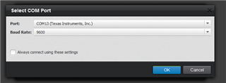

I have installed the browser extension and local application to connect to the board with CCS Cloud, but am unable to program the board.
I can connect no problem:
But cannot run:
This is how the board is recognized on dev.ti.com's home page:
In device manger, I see:
  - Under "Ports": "Stellaris Virtual Serial Port"
  - Under "Other devices": two instances of "In-Circuit Debug Interface"
    Note that this for connecting to the serial COM port on the LaunchPad and is different than CCS Cloud establishing a debug connection with the device via the required Stellaris ICDI connection.
    But cannot run:
    CCS Cloud tried to connect to the device using the Stellaris ICDI interface on the LaunchPad but it failed. Why it failed, I'm not sure. I assume the USB cable is connected to the LaunchPad from the PC and that the LaunchPad is powered? Did you import an example from Resource Explorer and then press the "Debug" button in CCS Cloud?
    That is expected. The TM4C123G LaunchPad is not supported by auto-detect.
    It should look like the below:
    Does yours match?

  • Thanks - let me take a look. I can confirm that I not what I see in device manager.
    Is the TM4c123G launchpad supported for CCS cloud?
    Can you provide a screenshot of what you see?
    Yes. The only issue is auto-detect for it is not supported.
  • Hey Ki - I actually was able to resolve this issue. Seeing your device manager screenshot, it looks like my drivers didn't install properly (since the devices were showing up as unrecognized) so I downloaded the drivers from the product page and manually updated them in device manager. It works now! Thanks!
  • Glad to hear you resolved the issue and thanks for the update!
