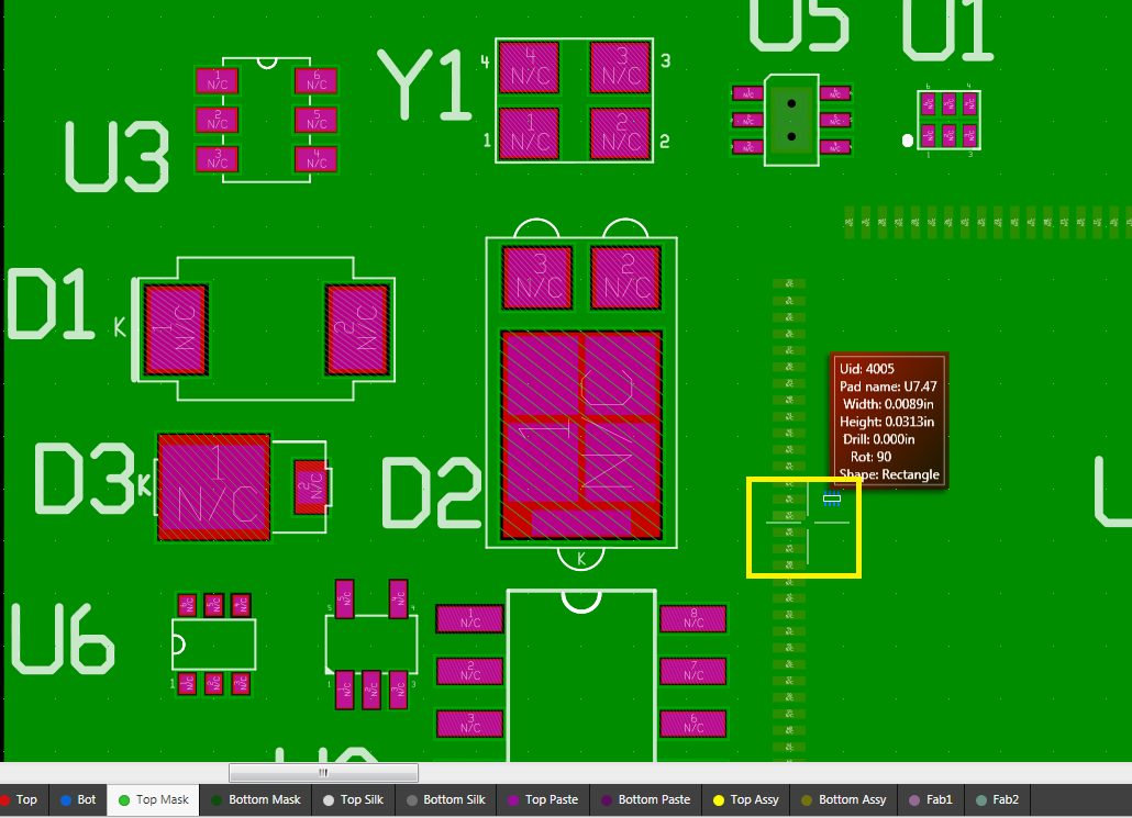

    Below are some custom footprints I made using the metric system was highly educational to say the least.
    The purple is solder paste, orange is surface pad, green boarder is solder mask keep out dimension .05mm-.07mm area surround top surface pad and solid green is top solder mask. All these were created using dimensions included in the vendor datasheet diagram. The yellow box is the naked TQFP footprint, has none of the above attributes. Ignore the inches shown in brown popup, footprint was made in metric but the editor defaults to inches and I didn't switch the grid to mm.

    Now at .194mm spacing between pads .04mm centers and 12.420mm end to end enter of pin. The board house DRC rule has .1778mm minimum annulus was generating 128 errors with a .023mm wide pad, so remade them .0226mm and 128 errors disappeared. Knowing what the recommended medium density solder mask keep out and solder paste are should be if any at all would help.
    This is my first PCB with a SMT chip in XL footprint so the mystery widens is the solder paste and keep out even recommended by TI when automated parts placement is expected?
    These kind of questions are fully disclosed in other TI datasheets for chips having smaller footprint size but omitted in the TM4C1294NCPD datasheet for what ever reason?

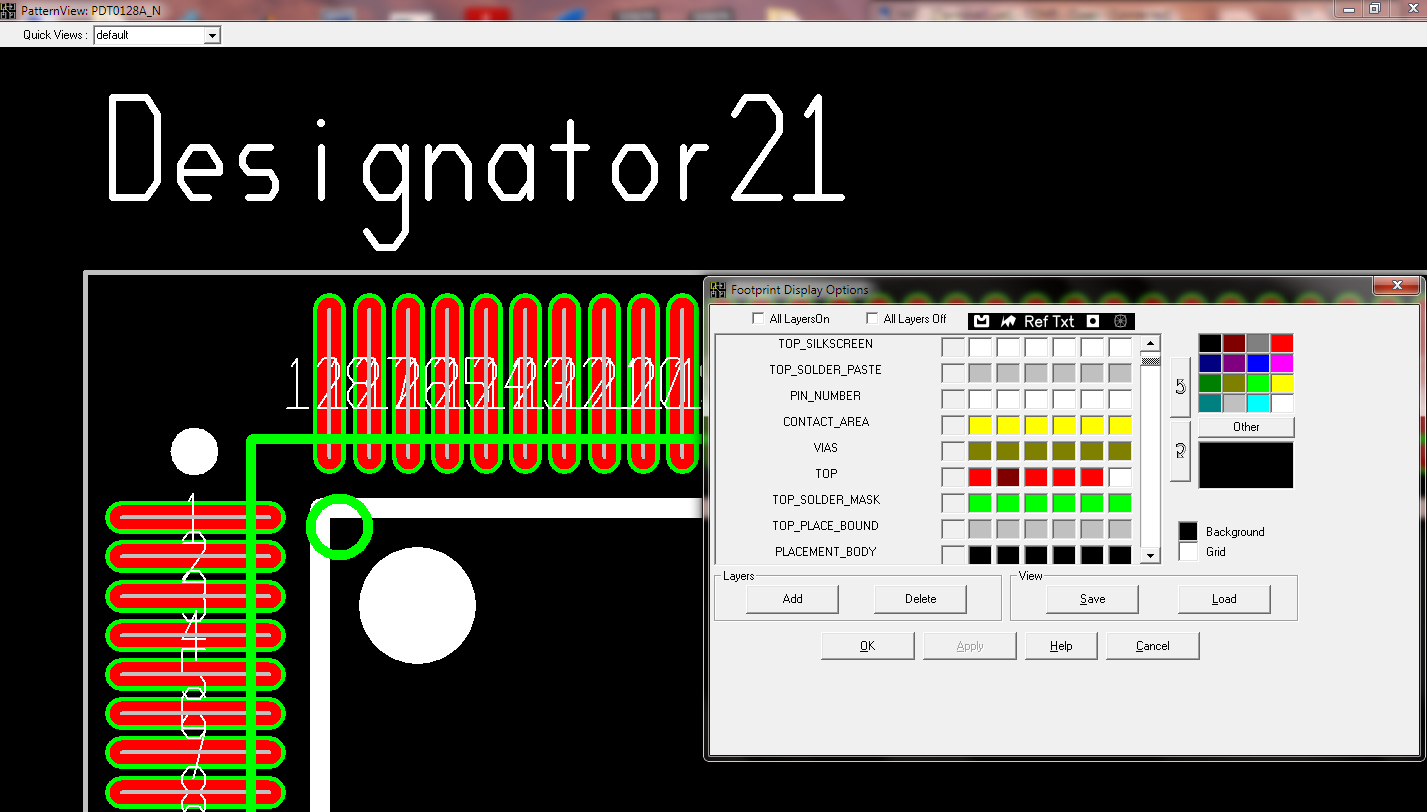

    Can you please post share that foot print diagram with the forum, that is if it has dimension lines etc...
    Perhaps I did something wrong but can not see the actual footprint in Ultra Librarian, is that normal?

  • Hi Amit,
    That is not entirely correct and Ultra Librarian will show the properly configured footprint with all vendor dimensions.
    The user must select display all layers to see the solder mask/paste areas. TI has not entered any dimensions for the mask area as several examples included in Ultra have dimension lines and numbers.
    Again we have to guess the width and length of the very elongated pad,  mask border and solder paste areas?
    BTW: The oversize numbers on the pads are not very impressive and become indistinguishable.
