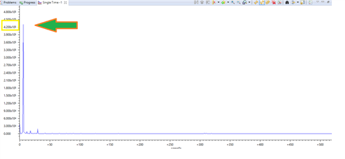

I'm starting to test/study the CMSIS lib in the Stellaris/Tiva. Using the paper "Using the CMSIS DSP Library in Code Composer Studio™ for TM4C MCUs", I got build the library and it works fine. The examples return the expected state.

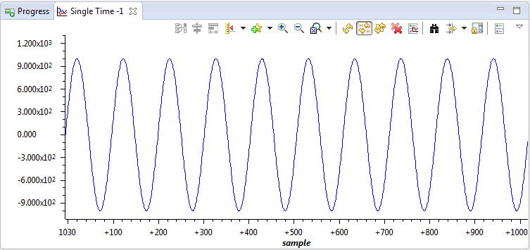

Now I trying to use the cFFT in a signal. To the test I created a pure sine wave in an array of 1024 samples (amplitude of 1000 and 10 cycles), as in the image.
After the processing the indexer return the correct harmonic (10th), but I don't understand the result of the magnitude. The magnitude of the 10th hamonic is 727.98. How it relates to the amplitude of the harmonic?

  • Hello Amit, thanks for the answer.
    Yes, the function "arm_max_f32( )" returns the maximum value and the position in the array, as described in the documentation: "Computes the maximum value of an array of data. The function returns both the maximum value and its position within the array".
    The indexer is ok, but I don't understand the value of the magnitude. I expected the value would be around 1000 (original amplitude).
    I did a test doing the inverse fft, and the signal in the frequency domain was transformed in the time domain, with the original wave.

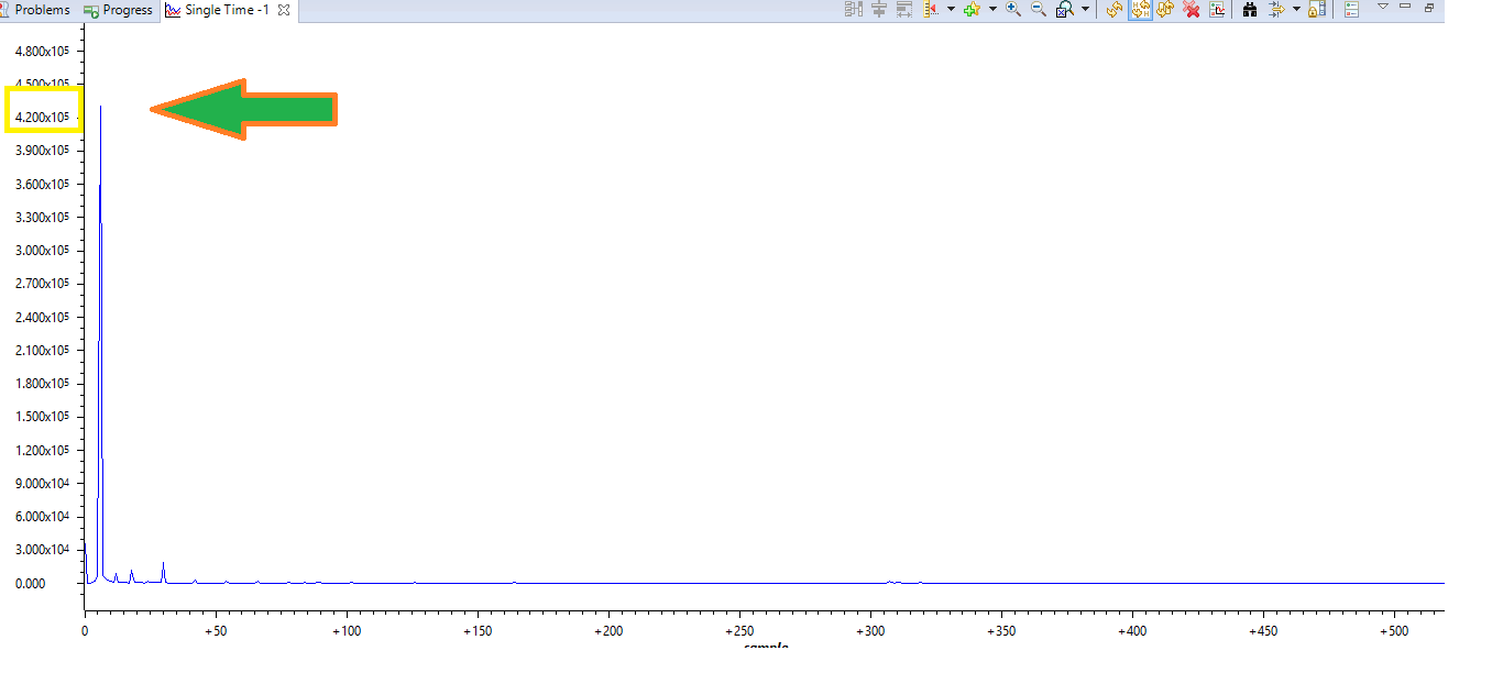

  • I tried to scale the sine wave between 1 and -1, but the result was the same. Instead of 727 the magnitude of the harmonic was 0.727.
    It's strange because for different numbers of cycles the result of respective "bin" change.
    Maintaining the same buffer size (1024) I changed to just one cycle and the result was around 708, very close to the RMS value. See this little list:
    1024 samples
    01 cycle -> 708.8323
    02 cycles -> 710.9644
    04 cycles -> 715.2491
    08 cycles -> 723.74
    16 cycles -> 740.4352
    I tried to change the buffer size to 64 samples to test. In this case the result of one cycle was around 740.
    I'm reading about how to obtain the amplitude, but in this moment I'm lost!

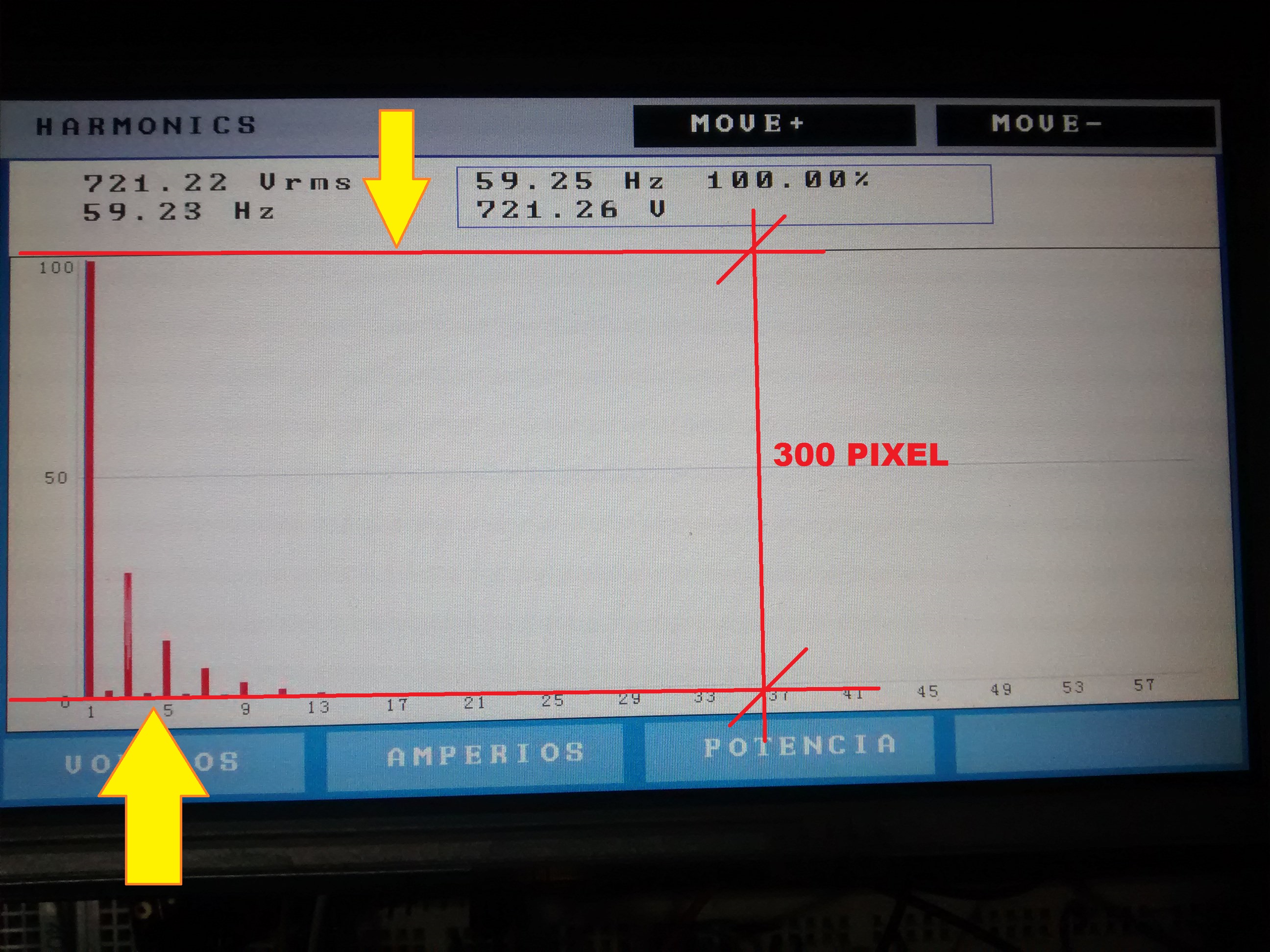

    In this part of code "arm_scale_f32(Output, 298 / maxValue, buffer, fftSize / 2);" - the value "298" in your project is related to the maximum projected value? Amplitude or RMS?
  • It has no relation with RMS; This value is selecione for my project.
    I use 300 pixels high to plot the frequency spectrum of a square wave.
    to avoid me unnecessary calculations; I multiply 298 pixels high.
    here image:
    for your application:
    arm_scale_f32(Output, Vrms/ maxValue, buffer, fftSize / 2);
    if you want to know what the energy of 10th harmonic , simply divide
    Energy_n = (Harmonic [10] / Harmonic [1]) * 100%
    the result interprets it as:
    the 10th harmonic has value% with respect to its fundamental

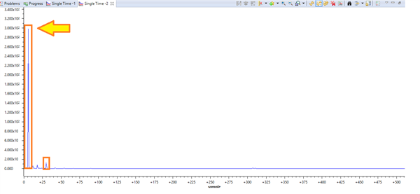

  • Amit you're right, Martin's reply does not solve the problem completly, but guided me the solution.
    The function "arm_scale_f32(Output, 298 / maxValue, buffer, fftSize / 2);" scale the magnitudes, in this case the maximum value will be 298 (specific Martin's case).
    In my problem I need measure the respective value of each harmonic and the unique reference value is the RMS value from the original wave.
    If I do this "arm_scale_f32(Output, RMS / maxValue, buffer, fftSize / 2);", the fundamental will be scaled to the RMS value. To solve this it is necessary to calculate a correction factor to be applied. This factor takes into account the quadratic sum of the harmonics after the fundamental. The function will look like "arm_scale_f32(Output, (RMS / maxValue) * correction_factor, buffer, fftSize / 2);"
    Now, I'm thinking it's possible to use the formulation without the correction factor, after the scale calculte the RMS with the magnitudes, then calculate the correction factor and scale again using this factor.
