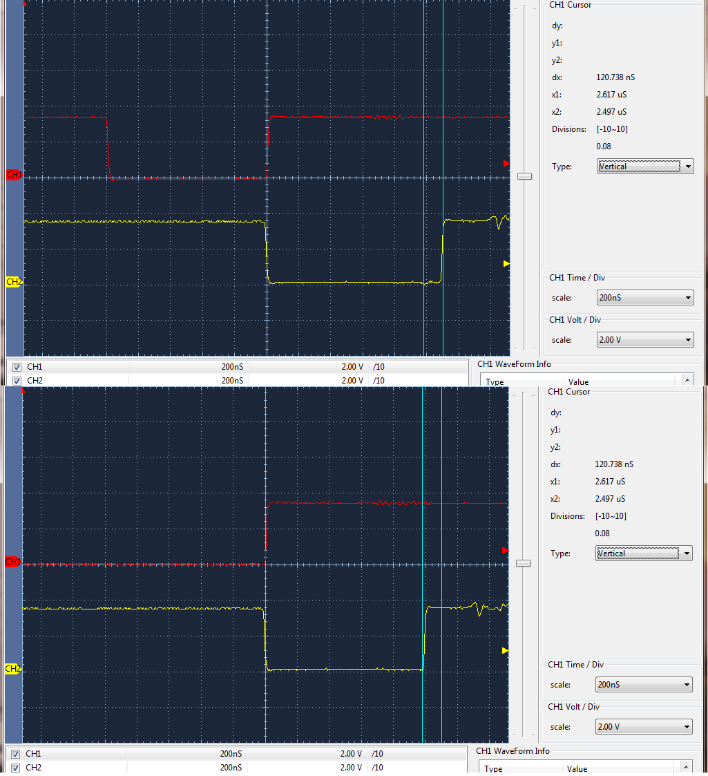

Provided register monitors recording differences CMPB in two different load values and resulting wave form (captures). That is the only way to detect the load count value failure since CCS debug shows CMPA/B register values being equal during the synchronous updates. The outcome of ignoring matches CMPB are missing edges in the pulse width changes made during synchronous update.

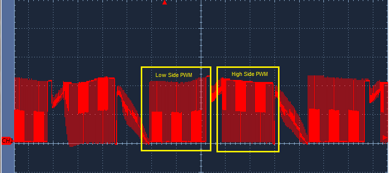

Newly discovered below scope capture Trapezoidal wave forms (produce) low side PWM when CMPB is not being (completely) ignored. Fast decay then produces in Full Bridge low side PWM when setting a starting pulse width CMPB below 100% duty cycle. That Is an indication CMPB becomes (jammed) when set nearly 100% duty and refuses to then process rising duty cycle values during synchronous updates of all 3 PWM generators.

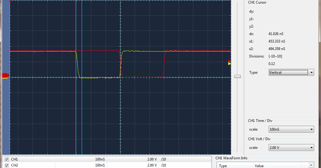

    CH1=pwmA, CH2=pwmB
    Notice FET body diode (dv/dt) CH2 seems to double clamp (ringing) and both high and low side PWM drives have (dv/dt) artifacts in the low/high PWM.  CH1 is low side pwmB drive 0.8us.

    CH1-pwmB, CH2-pwmA. Top/bottom captures CH2 indicate 120ns RED and not unexpected pwmB drops FED entirely (CH2 bottom capture) during minimum pulse width sync updates.
