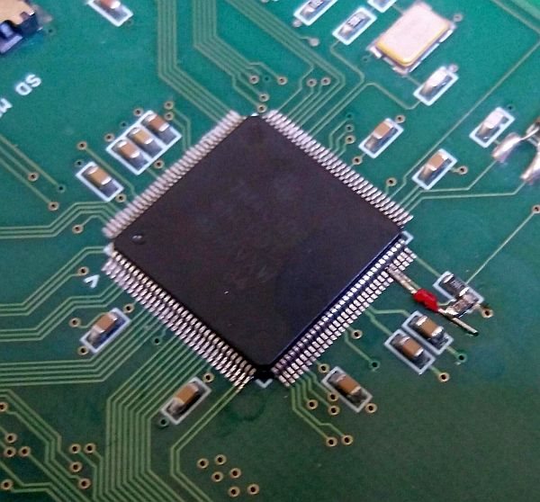

This post is about a custom board with a TM4C1294NCPDT. This product has just gone into Revision B, and the JTAG connections are a copy/paste of the same schematics successfully used in many other products of the company.
A batch of 5 boards was produced, and none of them will accept the JTAG connection for firmware transfer and debugging.

Using a scope on TCK, I can see an initial nice train of pulses on TCK, with square edges and true at 1MHz. Then it stops for a while and try again, before dying. There was no time today to view the other signals.
We do not use WPU's on the JTAG lines - never used, never had a problem - but recently accepted the suggestion and will do from now on. On two of these boards, we added 4 WPU's (3K3) on TMS, TCK, TDO, TDI. To no avail.

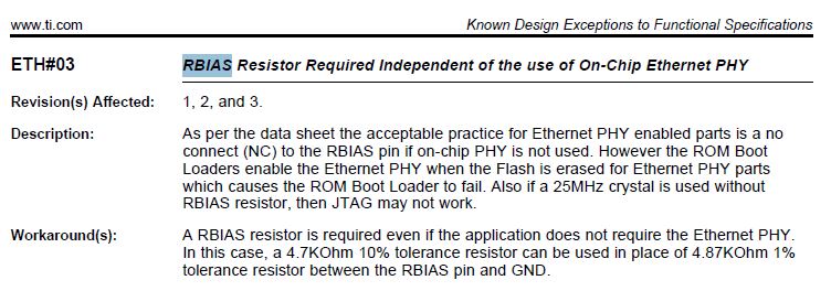

- Check at OSC0 pin that the crystal is properly oscillating.
- Make sure RBIAS resistor is properly populated... We DO NOT have RBIAS resistor, for this board does not use Ethernet. Datasheet says that preferred practice for unused RBIAS pin is NC. However, yes, there IS a 25MHz crystal into OSC0... Question 1: Could that be this exact problem?
Question2: where can I find the meaning for ERROR -2062 and other JTAG error codes?
