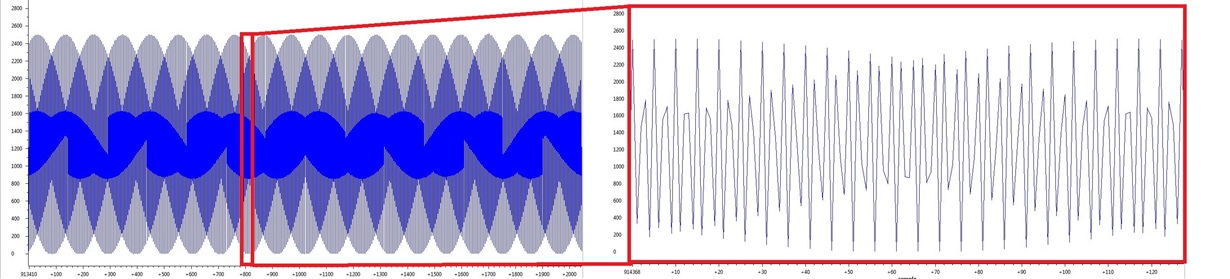

    I am trying to acquire a 100KHz sine wave (for now) with the on board ADC (sampling rate 1MSPS - "TimerLoadSet(TIMER0_BASE, TIMER_A, SysCtlClockGet()/80)")
    I'm attaching a screenshot of the Graph of the data array in which I am storing the ADC out put. The data array is 2048 points.
    Please, suggest what might have gone wrong?

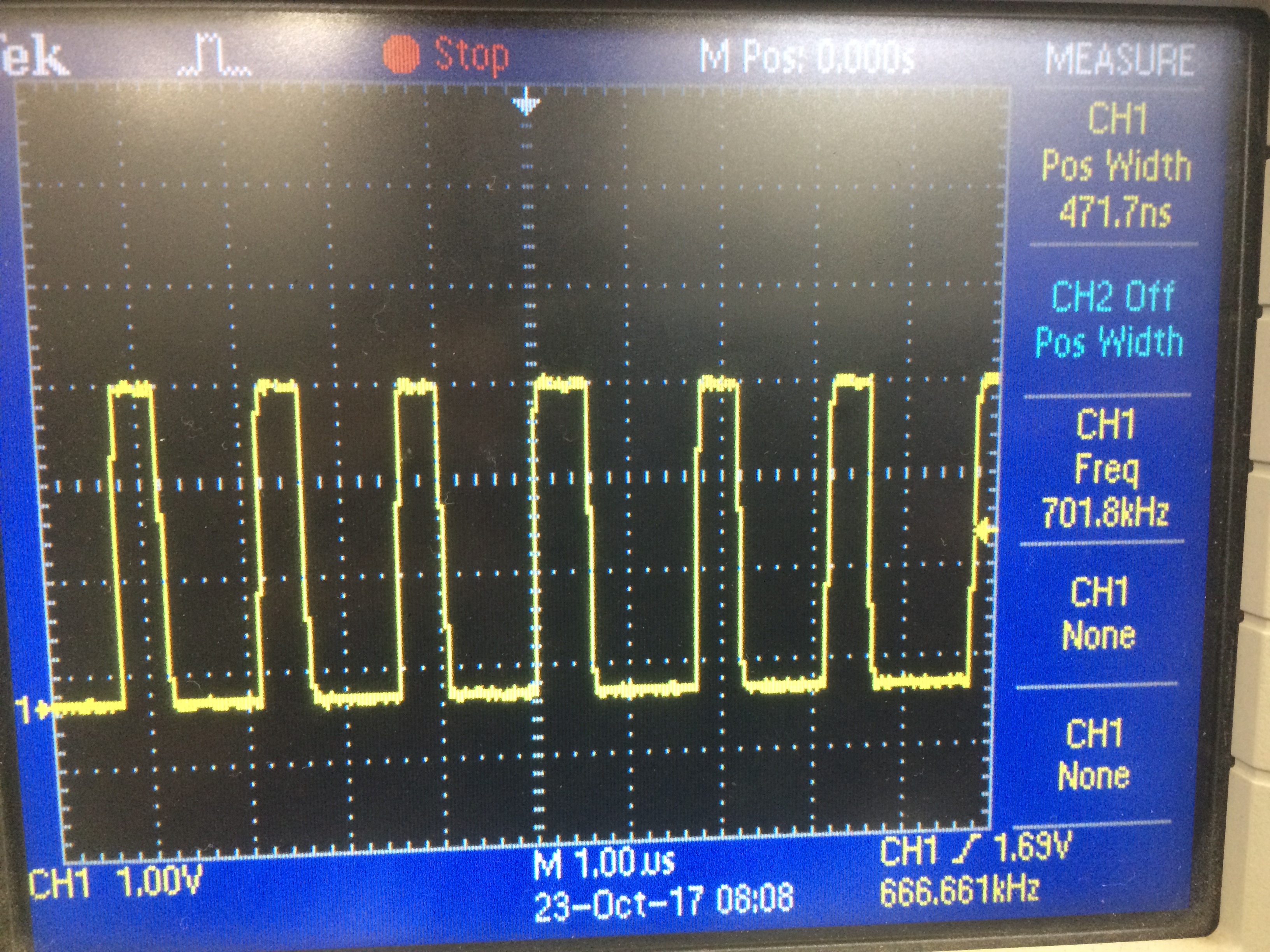

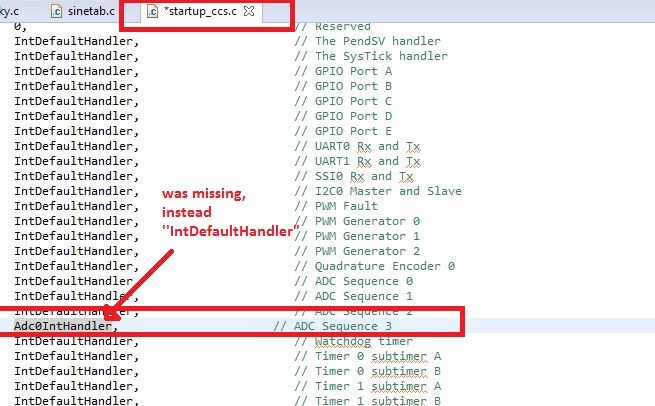

  • Hi All,
    Apologies for such late reply. I was not around due to some personal reasons.
    I am very happy to tell you all that the Issue is resolved now with all your help. I went through the whole issue again, and found 's post about the ISR routine not  declared in startup_ccs file.
    As the matter of fact "IT WAS NOT".
    The main code was pretty much the same.
    I had removed the Timer0 Interrupt handler as well "as suggested by many posters".
    I am able to trigger the ADC with the timer frequency which I could maximum attain upto ~700KHz (which I checked with a GPIO pin -> making it high and low to relate the entrance and exit of the ADC ISR)
    While your presentation of "ADC Trigger" is useful - it in no way matches the (required) detail - which your, "Graphic Screenshot" of 11 Oct 2017 provided.
    There ARE issues of significance - which are unlikely to be solved via "ADC Trigger" alone...      Is it not notable - that even after large passage of time - your post today "avoids" any "Graphic Screenshot?"    (as past supplied - and "so well" illustrated key aspects of your issue..)

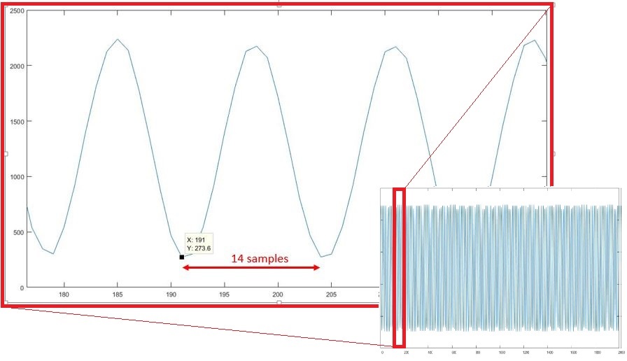

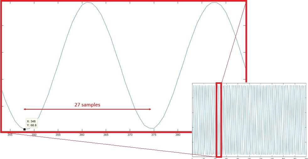

  • Hi cb1_mobile (1830783)
    "My bad" - I didn't upload the screenshots of the results
    Below are the adc outputs for 50KHz and 25 KHz sine wave respectively for 700KHz sampling frequency

    Yes the image uploaded in today's post (the one with the square wave displayed on DSO) is what I got as maximum sampling rate, which was achieved by following snippet.
    //Configure TIMER0
        TimerConfigure(TIMER0_BASE, TIMER_CFG_SPLIT_PAIR | TIMER_CFG_A_PERIODIC);
        TimerLoadSet(TIMER0_BASE, TIMER_A, 0x1); //Fastest triggering with 0x1 counter
        TimerControlTrigger(TIMER0_BASE,TIMER_A,true);
    I saved the output in an array and used MATLAB for further improvements like collaging or overlapping. (same for all images uploaded till now)
    I use inbuild CCS Single time graph to see the output at run time but use MATLAB for presentations.
