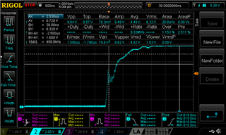

  • GHA-SHA Fall
    GHA- SHA Fall
    GHA SHA Rise
    GHA -SHA Rise
    SHA Fall
    SHA Rise
    The drive current for these waveforms was 350 mA and a gate resistor of 11 ohms. I have reduced the drive current back to 150 mA.
    Kindly comment on the ringing in the waveforms whether this is within allowable limits or not.
    Now the controller is able to handle higher loading when the current limiting is applied in the gate driver.
    Thanks for the help.

  • Hi Yashdeep,
    Thanks for the waveforms!
    There is definitely significant oscillation on the gate and source waveforms, suggesting the IDRIVE is too high. Additionally, the turn on time looks to be a little less than 100ns, which is quite fast. I would probably aim for a turn on time of between 150ns and 200ns. This can be done by reducing the IDRIVE and then tuning the gate resistor appropriately. If you need to use a gate resistor, I would recommend using a small value, maybe 10 ohms or less. You mentioned that you reduced the gate drive current back to 150mA. If I was understanding it correctly, you used to get a fault operating with that low of an IDRIVE, is that correct? I think you mentioned that it had to be 400mA/800mA gate current in order for there not to be a fault during startup. Was this issue resolved when you used the current limiting feature? If the driver operates well at the lower IDRIVE current then I would recommend using that, especially since the FETs are low Qgd.
    The abs max 200ns transient SHx pin voltage is -10V (negative transient) and Vdrain + 10 (Positive transient), so it looks like the abs max voltages are not being violated, however I would still recommend reducing IDRIVE since you are seeing significant overshoot/undershoot which can cause EMI issues.
    I am glad that the current limiting feature allows for higher loading! I would still like to figure out what is causing the VDS monitors to not read accurately, but likely that would require going back to the dynamometer and running tests and getting VDS waveforms and measuring the actual current. It is up to you if you want to go down that route.
