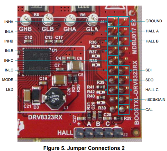

  • Hi ,
    I am try motorcontrol SDK example.
    Ask a question about the connector, because the  BOOSTXL-DRV8323RS is used, I refer to the reason why the PDF(BOOSTXL-DRV8323Rx EVM User’s Guide & BOOSTXL-DRV8320RS EVM User’s Guide) contact pins do not completely correspond, because it is the Launchxl-F28069M, do I need to use the plug-in pins for connection?
    Jerry

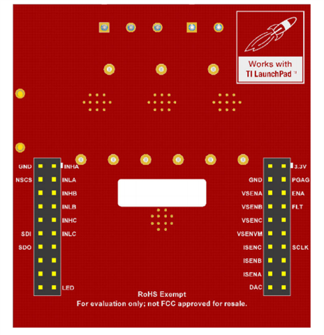

  • Sorry, this is my first time to use TI product, so I have some doubts about the pin setting.
    I read this document.
    Launchxl-F28069M and Launchxl-F280049C (J4,J2) are similar, but why J4-12/GPIO23 (launchxl-f280049c) connect to J4-19/GPIO57 (launchxl-f280049c)?
    InstaSPIN Quick Start Guide
    Launchxl-F28069M and BoostXL-DRV8323RS Connection don't break some connections.
    Are these pins originally connected like this or are they corresponding to the board?
    So change these pins connected that I can use Launchxl-F280049C +  BoostXL-DRV8323RS, I don't have to change the settings of the program so that the board can be controlled.
    Can MotorControl SDK support Launchxl-F28069M, I only have this board.
    If it can't support, maybe I should be use MOTORWARE or buy a Launchxl-F280049C to control.
    I mistakenly thought you were talking about Launchxl-F28069M.
  • Launchxl-F28069M and Launchxl-F280049C (J4,J2) are similar, but why J4-12/GPIO23 (launchxl-f280049c) connect to J4-19/GPIO57 (launchxl-f280049c)?
    To use the SPISTE pin directly for the SPI interface to connect to the CS pin of the DRV device.
    You have to use MotorWare for  Launchxl-F28069M, the MotorControl SDK doesn't support Launchxl-F28069M.
    Please refer to the link below as mentioned before to use Launchxl-F28069M with BoostXL-DRV8323RS since you have these kits on hand.
    [FAQ] BOOSTXL-DRV8323RS and BOOSTXL-DRV8323RH InstaSPIN and MotorWare support
    https://e2e.ti.com/support/microcontrollers/c2000/f/171/t/635499
