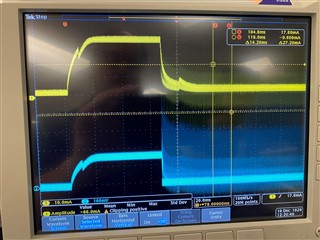

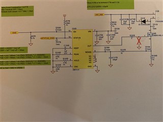

This circuit design was based on the previous posting (see DRV110EVM: DRV110 14 pin). Here it the updated design:
The expected values are as follows:
Ckeep = 100ms
I peak = 32 ma
I hold = 16 ma
Fosc = 25 kHz

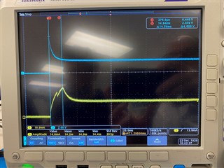

Problem#1 is I hold = ~5ma and drops the solenoid contact. Additionally, very noisy hold current. Here is a screen shot of the trace. Blue is current probe of the solenoid. Yellow trace is the enable.
Problem #2 is that Ckeep =~80ms

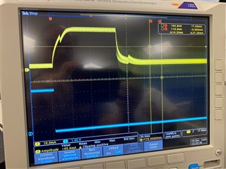

Next, all I did was add a .1uf cap in location C133 and here are the results:
By decreasing R hold (R164) to 90K ohms I can get the solenoid hold current up to ~16ma.
What are your thoughts on the circuit not functioning as intended?

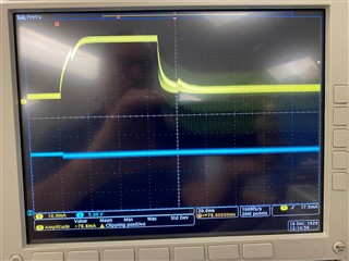

  • Hi Kevin, The purple trace is the enable signal. I will send you the scope pics for the other TPs.
    -John
  • The yellow trace is the current through the solenoid. This is the same on all scope traces. The Blue Trace is TP53B (Vin)
    The BLUE trace is TP58B. Apparently, the capacitance of the scope probe is affecting this signal.
    The BLUE trace is TP59B
    Additionally, this is U26 pin 11 (OUT)
    And this is TP57B (STATUS)

    • Could you share details on your current limiting resistor calculation? Recommended values can be found on DS pg.16, table 3 - when EN is toggled high/low RS = 13k.
    • Any reason you choose 5.6ohm instead of 1ohm RSENSE value used per DS?
    • Also, I assume you've verified your CKEEP value, have you tried increasing the capacitance (+0.1uF)?
    • Perhaps you could try modifying EN pin, etc to that similar in the reference design resource - TIDA-00289 Current Controlled Driver for 24-V DC Solenoid with Plunger Fault Detection Reference Design | TI.com
    • I wonder what would happen if you replaced your schottky diode with a normal pn diode.

  • Hi Kevin,
    C133B is on the gate of the FET. In the schematics it is shown as the RED X (DNP).  The C133B  large capacitance (.1uf) is causing other problems but I can start by eliminating it and using only a pull down resistor on the gate of the FET. I will try a 1 k ohm pulldown and verify if it eliminates the gate noise.
    • I will update the circuit for when EN is toggled high/low RS to 13k. This was an error and missed on my part by using the existing 4.7k ohm pulldown. I reviewed the reference design but don't feel this should not cause the noise problem.
    • The 5.6 ohm Rsense was chosen based on using the DRV110  Device Parameter Selector.xls spreadsheet. It is not clear if TI or you are recommending Rsense = 1 ohm as per the DS. I was able to meet all the other Ipeak, Ihold, Tkeep, fPWM by using 5.6 ohms in the calculation.
    • I am not that concerned about Ckeep time being off but I did verify that the capacitance value is correct.
    • Yes, I can try a normal diode such as the part number US1B-13-F shown in the reference design.
    Any thoughts about the Zener voltage? The TI spreadsheet shows a recommended value of 7.725K ohms for a 24 v source. The existing circuit is using 4.99k.

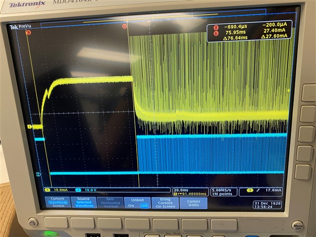

  • Hi Kevin, Here are the results of some of the recommended changes:
    1. The 13 K ohm pulldown on EN has no effect on improving the circuit. Top trace in BLUE is EN. Bottom trace (yellow) is the current thru the solenoid.
    2. This is the circuit change with 13k ohm pulldown and 1k pulldown on the gate of the FET. Top is the gate voltage of the FET. The 1 k pulldown on the FET is eliminating some of the noise on the current trace shown in Yellow.
    3. This is the circuit change with 13k ohm pulldown on EN, 1k pulldown on the gate of the FET, and 7.75K ohm on R81. Top trace is the gate voltage; bottom is the current thru the solenoid.
    By reducing the Zener current for the internal zener on the supply pin helped to eliminate the noise. This change is required.
    Now the circuit is functional because the solenoid is staying engaged. The hold current is approximately 14.5ma.
    Also, Tkeep is only 14.56ms and there is no PWM. So, these are the next issues.

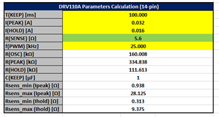

    Here are the other parameters from the spreadsheet:
    John

  • Hi Kevin, Here is the data from the spreadsheet that you requested. Now, I am coming up with 4.45K ohm (R81B) for my 24 volt Vin.
    Based on this data, R81B= 13K ohms is too high and the circuit won't work because I_Zener is less than the data sheet minimum (1 mA).
    I also  recalculated using I_zener = 1.28.ma. Now R81B comes out to 4.99K ohms. This is the R81B value from the original circuit and this value should work.
    Let's discuss how you would like to proceed.

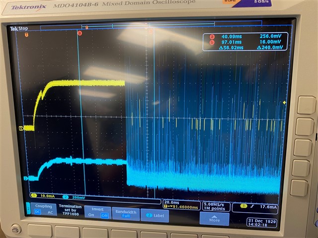

  • Hi Kevin, I tried the recommendations from your message and the updated spreadsheet. Now Rzener = 5.7k ohms and also removed the pull down resistor on the FET. The Rsense = 9.1 ohms and Rpeak = 200 k and Rhold = 50 K (as per the spreadsheet).
    Unfortunately, the circuit still does not work and the solenoid does not stay on.
    Top trace is current probe (I_solenoid) and bottom is the gate of the FET (V_OUT).
    This includes the Vsense signal. Now, when the solenoid is on the Vsense has increased to 256mV. The PWM is now working at 25Khz but the I hold is way too low.
    Recall the requirements from the datasheet:
    FYI, if this applies to my design Rhold should not be less than 66.7k and we have it set to 50 K.
    John
  • Hi John,
    Now it seems like your circuit is switching too fast, could you increase the resolution of ISOLENOID? I apologize for invalid parameter recommendation as I overlooked this item, makes sense IHOLD is not reading correctly here in this case. However, glad to increased sense voltage helped with PWM. Updated recommendations:
    I have a couple more suggestions:
    Do you know the inductance of your solenoid? It may help to add another coil in series with the driven inductor
    Have you modified the recommended RC filter at all? I suggest to try replacing 100pF with 1nF to increase time constant.
    Kevin

  • Hi Pablo, DO you have any recommendations yet? Or, do you understand why the circuit is behaving this way?
    -John

  • Hi John,
    Apologies for the late reply.
    I met with Kevin yesterday to discuss this in detail. Can you provide more information about the solenoid you are using. What is the inductance and resistance? I can work on the TINA simulation.
    It looks to me that the main concern here is the HOLD current being low and the noise in the output current. Let's tackle the HOLD current issue first. You are able to increase the hold current to the desired value by decreasing RHOLD. So it seems this fixes this issue. Now going back to the noise in the current, This may be due to PCB layout or noise being coupled to the output terminal of the solenoid. Can you share the PCB layout? You can send it via private message if you don't wish to share in the public forum.
    In the meantime, let's try to the following to minimize the noise in the output current:
    1. replace R102B with 15Ω. This will slow down the output voltage (at the drain of the MOSFET) rise time which will help minimize the current spikes.
    2. Add a capacitor to C133B. I know you have already tried 0.1µF and it seems to help minimize the noise. Can you try other values (100p - 0.1µF). Based on the waveforms, there is also a lot of noise on the gate voltage which may be getting coupled on the output or enabling the FET for brief moments causing the large current spikes. The capacitor will short some of the high frequency noise to GND.
